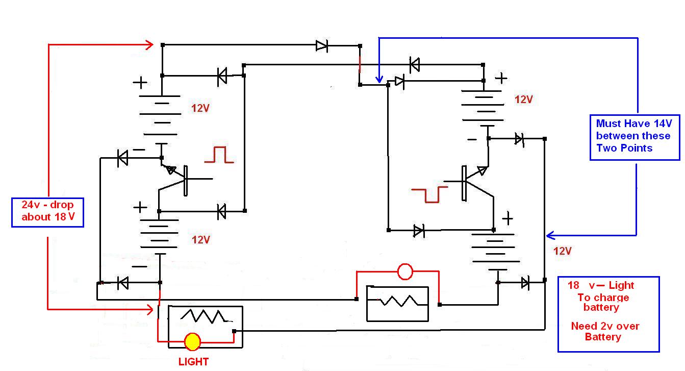

Reference the attached pic from JB. You'll also need to just have one side on all the time, not alternating (i.e just Q1 & Q10) to do this test.
The idea is to get the most voltage over the 12V bank (at least 14V), whilst having the most voltage on the 24V bank (at least 18V). As JB says, you need at least 2V over the battery to get it to charge.
Set you meters up as per the picture and start with a small load like an LED, but make sure you have the same load on each side even though only one is lit up. Measure the voltages and record them. For example, when I used an LED (with 330R to protect) I got 13.08V for the 12V bank, but 23.8V for the 24V bank. The point is that I don't have enough to charge the 12V bank, but I have heaps of potential to use on the 24V bank.
OK, next try the other extreme like a car headlight halogen bulb. When I did this I measured 13.29 (after 15 seconds) on the 12V side but under 18V on the 24V side. The other problem was that the halogen took too long to light up - which means you can't switch fast enough to get any charge into the 12V side.
The best result I had was 8 x #47 bulbs. These were arranged so I had 4 pairs paralelled of 2 bulbs in series. I had the same load setup for both sides. With this arrangement it gave me 13.28V on the 12V side and still 23.16V on the 24V side. My batteries were all 130Ah big Trojans.
All 4 batteries did charge up slowly - about 0.01V every few minutes, but then they all stopped gaining after about 30 minutes.
When you do this test, it's also a good idea to have a meter on the bottom battery on the 12V side to see how fast (or if) the voltage increases.
I don't think I still had the right load, but I was starting to run out of #47 bulbs.
But then I put the same load (8 x #47) on a set of 7Ah gel-cells and it was too much for the 24V side - so that's why I said you have to pick the load for the battery size you are using.
Anyway, that's my theory which I still have to test out properly on the bench. I'd like to get some 1157's and four motorcycle batteries as the only decent fooded LABs I have are the big Trojans and it takes too long to see any impact. (And the 7Ah gel-cells are too unreliable)
Let me know how you go...
John K.
