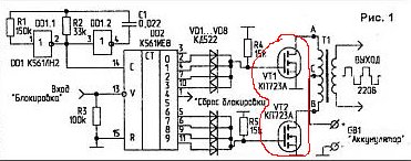

Delamorto simple inverter device

Another issue is to convert schematic of inverter from Russian elements to international : I found that CD4017 most probably is the same as Russian K56IE8 chip in schematic but as I cannot find K56IE8 datasheet I cannot match terminals of both
Need help from our Russian fellows - please locate K56IE8 datasheet and compare to CD4017 , without this we cannot replicate this circuit.
Ok, I did some research and found that at probability 99% K561IE8 is a counter chip which replacement is CD4017 and terminals seems to be the same if my Russian language don't fool me (it's rather limited)
KP723A mosfets used are 60V 35A nice ones with very load resistance 28mohm.
Replacement would be IRFZ44 I suppose.

That makes more sense. However the circuit in your post above shows two vacuum tubes - VT1 and VT2 and the diagrams are of vacuum tubes. What circuit does that relate to? (attached below)Originally posted by boguslaw View PostNo vacuum tubes at all. Here is his (delamorto) post

VT1 and VT2 are Russian N-chanel mosfets. International replacement would be IRFZ44 or better IRFZ48Originally posted by ewizard View PostThat makes more sense. However the circuit in your post above shows two vacuum tubes - VT1 and VT2 and the diagrams are of vacuum tubes. What circuit does that relate to? (attached below)
Inverter is made and schematic is in one of my posts above however using Russian electronic chips. We need a little help to replace them. The essence I see in schematic is usage of counter divider chip to chopper output signal of normal CD4047 based push-pull inverter. I may be wrong because my electronic knowledge is limited.Originally posted by Farmhand View PostHi Boguslaw, That device requires some parts I don't have either. I would need

Thanks, sure looked like a Vacuum Tube symbol of sorts and I guess you could say the VT had me thinking Vacuum Tube.Originally posted by boguslaw View PostVT1 and VT2 are Russian N-chanel mosfets. International replacement would be IRFZ44 or better IRFZ48
Hi all
I think the key is the waveform, is not a square wave,outputs 0 and 5 are to insert in each half-cycle time off.
If there is no replacement for K561, you can use any simple oscillator clock input of 4017. The frequency will be x10 (10 steps one cycle)
