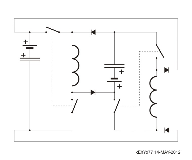

                  It uses the same principle described in this thread and is based in some way on the Infinite Power Supply idea.
                  I present only the idea without pointing to specific components.
                  This is suppose to be a push-pull inverter stage on the 2 opposing primary coils (i.e. audio type transformer in reverse).
                  The coils cannot be in a form of a center-tapped primary.
                  Drive it with short pulses, alternatively, reserving some time for the inductive kick to charge a mirror battery, probably through a choke (not shown)
                  in order to minimize the current hitting the battery (when for instance gel cell are used).
                  Secondary winding of this transformer is not shown here...
                  I bought some beefy IGBTs rated 1200V and same rated fast switching diodes...
                  Time to experiment!
