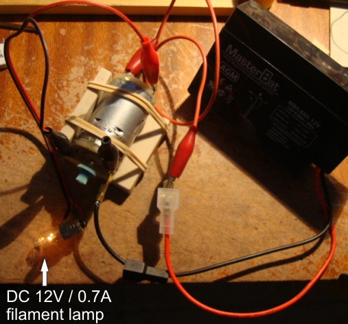

                  Edit 1:
                  here attached a pic of it running with a load at output. (the lamp is dim, and slows down the motor when switched in).
                  Ok, try with a Cap In and a Cap Out (Both Parallel)..The In Cap could be a small electrolytic like 10-33 uf 50 V, and at Output use an AC (Non Polarized) 5-10 uF 120 or 220 Volts...and see if that helps lamp and Motor does not decay in speed...while load on.
