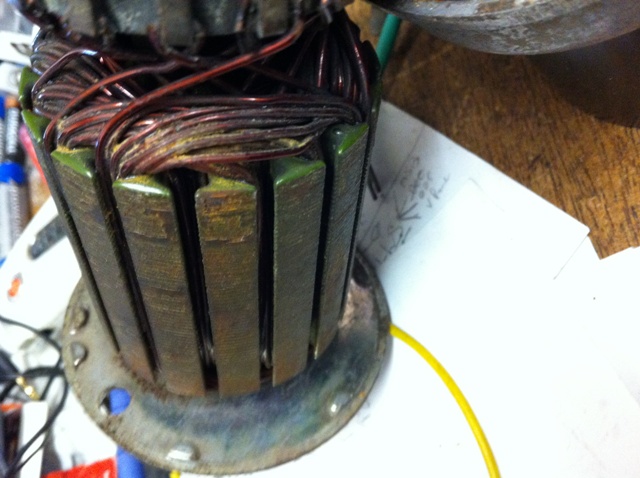

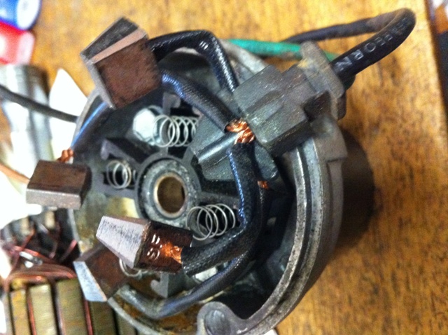

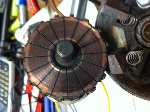

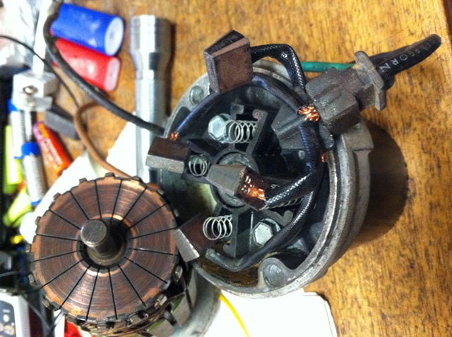

    I had not seen a brush/commutator arrangement like this, prior to openening
    this motor. I was from a homemade winch. I think it may be a starter motor?
    What is the possibility of using this type of motor for the UFO design.
    The rotor has 16 poles. The permanent magnet stator is two magnets BUT
    they have two poles when checked with a small magnet. So four pole and
    four brush.
    Regards, Penno

      I do have a four brush housing w/four brushes in the golf cart starter/generator.
      Also should the commutator be same with 16 bars?
      Thanks,
      wantomake
      Hello Wantomake,
      I told you before...that a Golf Cart Starter/Generator will not work for this.
      They do not have room but just to run a single wire heavy gauge through their poles...or is it different than what am saying?
      The Brushes, yes, you could use them for other project...and commutator could be higher number as long as they are divisible by the poles number.
      Ufopolitics

        Hello Penno64,
        Yes that is called an "Axial Commutator-Brush set-up"(Radial is the Common, typical one) ...I have build one based on a BOSCH Gas Pump for FORD F-150 Pick Up, but a 12 poles...
        And yes, you can convert it ...as long as your shaft allows another commutator same number of poles, and it don't need to be Axial...but a Radial will do...except Axial take less space from shaft.
        What is really weird is that it has two magnets and they are built with two poles each within... ...never seen that before...and that gives you no Gap between those two built in poles...so we will have to figure that out to even the forces...but not a big of a deal...
        You should take it into a CAD, but scaling with accurate dimensions...
        Ufopolitics
