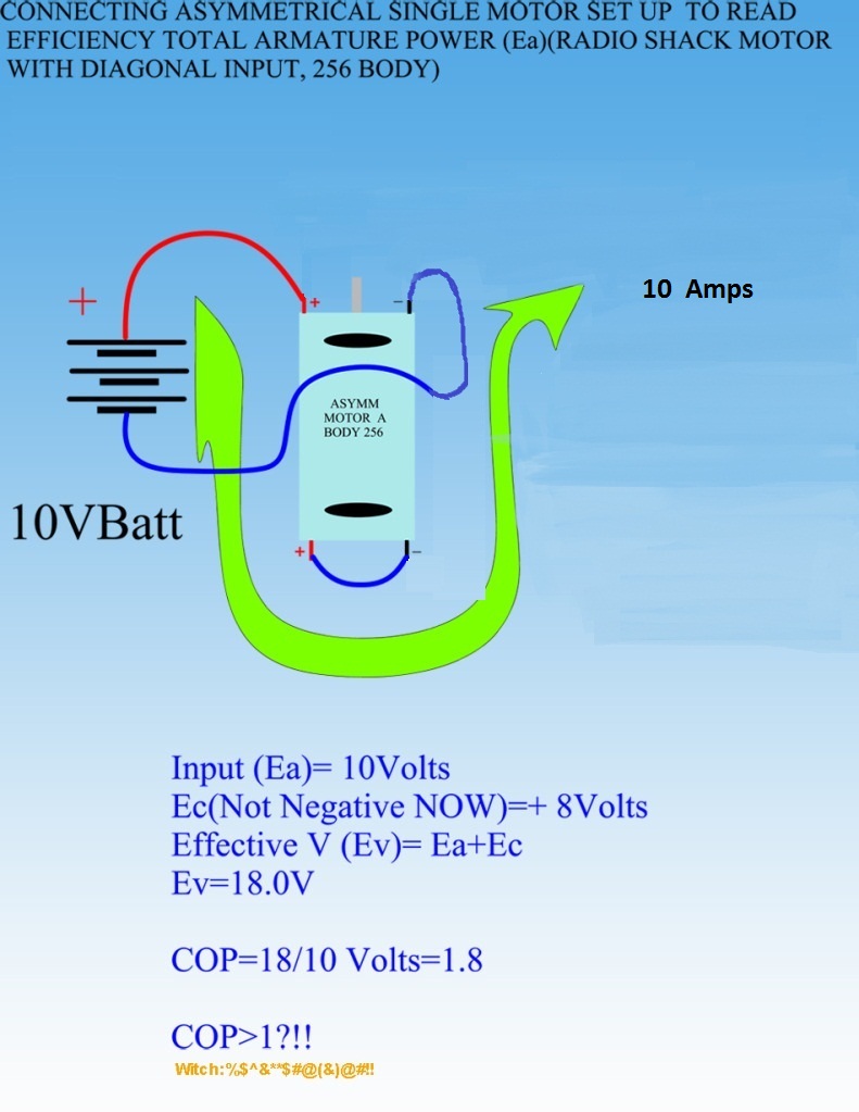

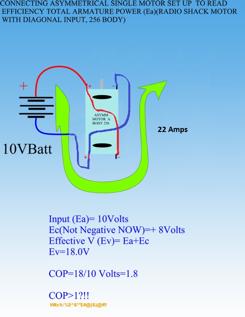

              • Hello Ufopolitics
                Here Im again .I read your posts as a worty guideline .Before I rewound the rotor I made some experiment with it .I found that there are 2 wiring ways ( Perhaps more but I dont know now )At wiring pic1 you see that it draws 11 Amps at pic2 22 Amps.Which will you emphasize for generator and which for motor? Or you suggest other wirings.I ll rewound it complete and wind again with another AWG and turns .If people are interested in I ll give my results later.
                Thanks for guiding
                selnet

                        • Hello Selnet,
                          Originally posted by selnet View Post
                          Hello Ufopolitics
                          Thanks for guiding
                          selnet
                          Hello Selnet,
                          So You "found"...two or more ways to wire-connect My Machines!!??
                          Selnet, I have displayed already, ALL the possible ways, to hook this Machines...I really "doubt"...there could be another way.
                          In the First Picture You have changed the connections...the one that draws 10 amps...All you have done is Converted Back to a SYMMETRICAL Machine...You are REVERSING Polarity at every turn, since you have Positive-Negative Input, at same Commutator level...The only difference, is that here, Pairs-Coils are NOT connected in series between them, like a "Typical Symmetry",...but independent from each others...You have No output here...it is just a Motor.
                          You are killing Radiant Output...and creating back EMF again.
                          In the Second Pic, 22 Amps...You managed to create a Dual Symmetrical Machine...You are reversing polarity galore there...at upper and lower commutator levels.
                          Selnet, by doing this type of connections...I honestly tell you...You still do NOT fully understand this Technology.
                          So, my friend, please, do not try to come here and show me, teach me...there "could be even more ways" to hook this machines...as your conclusions could really bring confusion among other Members starting to read here...I will appreciate if you learn this technology fully first...going by all the several, and very clean diagrams I have displayed so far...before trying to "Improve here"...please and thanks.
                          Ufopolitics
