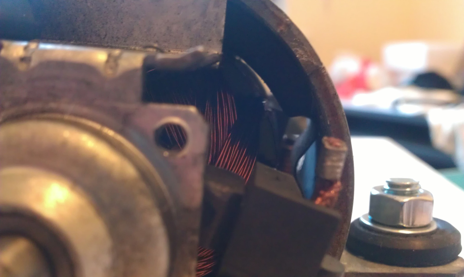

Hi DavHav and All,
Thank you for your comment. Certainly I take into account the info about you wrote. The rotor on picture was re-winded. I tried to wind as much turns it is possible, so there are 30 per coil and 1,4Ohms. The motor has been operating for more than an hour...nothing goes wrong with wiring. Here is the assembled one and now I working on another rotor for second machine.
