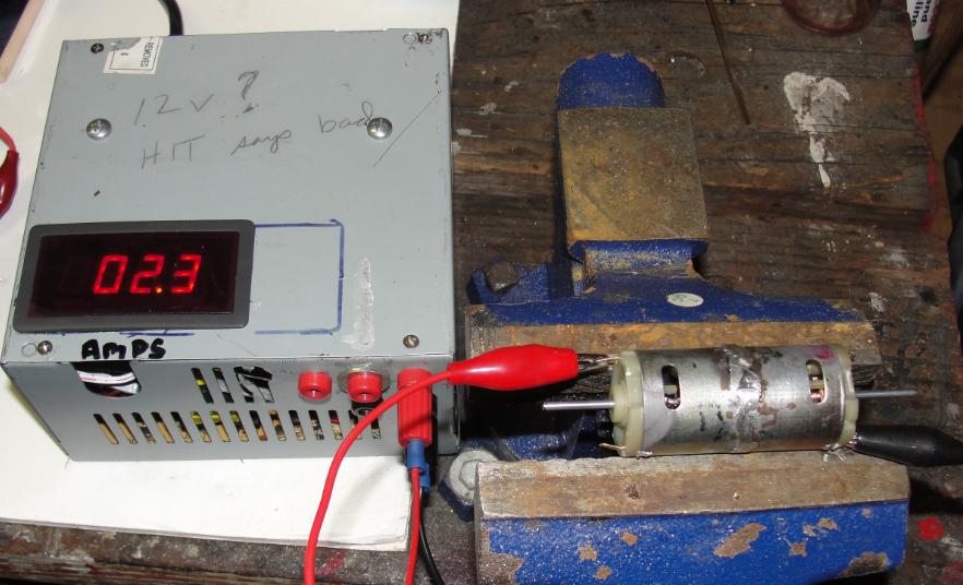

RS motor problem
Some input on my Radio shack motor project is sorely needed. Anyone jump-in, greatly appreciated!

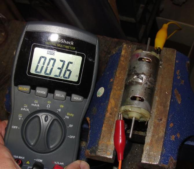

I just combined two bodies trying to make a more powerful motor since it was the same amount of labor. I originally thought that the bushings were too tight on the pieced together shaft and that it wasn't true and the motor must be binding. It did not turn very freely. I tore it down and replaced the 2-pieced shaft.
Motor just gets hot. No hum. I have a nominal resistance of 3.5-4 ohms per coil.
You can see the plastic poles in the body holes which indicate my brush placement. I think it is in accordance with neutral timing on this diagram:
Winding Diagram 5-pole photo by sampojo | Photobucket
Hooked up to a power supply it got up to over 100 degF, hot to the touch, drawing 2.5A.

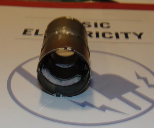

Lets look at magnet placement:
south poles lined up photo by sampojo | Photobucket
The light pink denotes South pole, and you can see the magnets are abutted in "series", N to S.

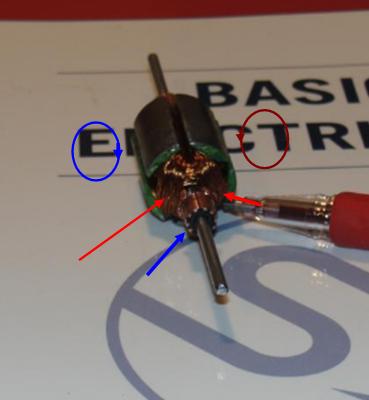

So lets look at windings. Here is a blow-up of the 5-pole winding:
RS 5-pole Blow-up photo by sampojo | Photobucket
Looking at my last winding, indicated by the bright red arrows, it start at the front commutator at the 240 position(blue arrow), goes under the shaft to the right half coil and is wound CCW(viewing coil from the "bottom"), shown by the red oval, transitions to the left half, and now looking at the coil from the "top" was wound CW(blue oval), maintaining the "winding in the same direction".
Last wound coil annotated photo by sampojo | Photobucket
What did I miss?

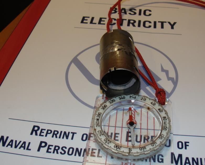

Hi Sampojo
Is the motor running, or is it getting hot while static? Did you use 1 pair of magnets or 2 pairs?
It looks like the brush position is correct.
It may be worth taking the rotor out and with some resistance inline connect to your power supply each commutator pair and then check with a compass needle that you are getting a N and S pole from the respective rotor poles, so check all 5 segments.
JohnLast edited by john_g; 01-09-2013, 08:58 AM.
hi John,
getting hot STATIC. Its dead as a doornail. 2 pairsOriginally posted by john_g View PostIs the motor running, or is it getting hot while static? Did you use 1 pair of magnets or 2 pairs?
OK, but everthing is relative right? It doesn't matter which one is north or south, just one of each?Originally posted by john_g View PostIt may be worth taking the rotor out and with some resistance inline connect to your power supply each commutator pair and then check with a compass needle that you are getting a N and S pole from the respective rotor poles, so check all 5 segments.

Hello Sampojo,
Ok, make a test on Rotor...
Use a couple of 1.5 volts batteries...in series so it would be 3.0V...
Test first P1, by feeding from top-bottom connecting terminals...and use your compass to check you are getting North-South where they are supposed to be...
Do that with the rest...P2, P3, P4 and last P5...
Mark them as you go ...and make sure you DO NOT TURN the rotor while doing tests, so always same positive side...
You should have problems there...in the Pairs.
Motor is locking up...and no run...
Second tests:
Test for Ground leak on each with continuity meter...one element and ground...on all five.
Let me know...
