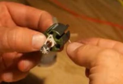

                              • Poss. Discrepancies to winding vids, pdfs regards to RS and in general
                                Hello Sampojo,
                                Take a look at this video...
                                Asymmetric DC Motor - Winding Question - YouTube
                                He starts at 2:00 to simulate the winding (and He is got it correct), the only problem He had was the Brushes positioning were wrong.

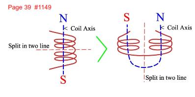

                                Hi Ufo & other senior members, need to clarify some inconsistencies that are possibly misleading for any winding. The compilation of Alvaro is quite excellent, but let me see if we may agree on some things.
                                on Page 3, from post 1148, a possible error here:

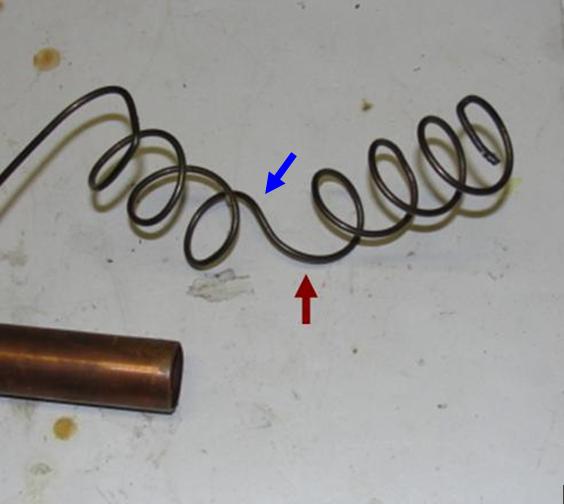

                                I contend that the bent coil reverses direction at the bend exactly opposite of what numerous written texts say, that the same direction of winding should be maintained. To illustrate see this normal coil wrap below:

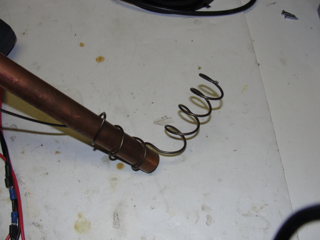

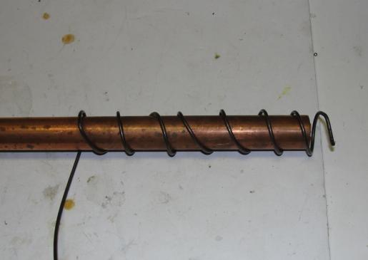

                                You cannot doubt that it is unidirectional. Now lets bend it to make it asymmetric.:
                                Slipping it completely off the tube, notice exactly how the arrows transition track looks like:

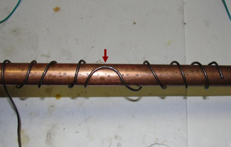

                                Now lets do a coil that clearly changes directions of winding, shown at the red pointer:
                                Slip it off the tube:
                                This is exactly what is shown from post 1149, and must be wrong.
