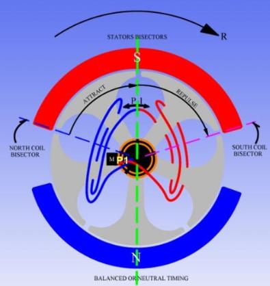

    Guys, about the winding mode...I display it clearly on My Asymmetric Winding Part 1... video...
    I always use this Method to Wind ALL My Machines...and as you all know...they ALL work...
    Now I follow the Positive Direction from the Positive Wire from the Positive Side Commutator...towards my fingers...sometimes "I" Direction tends to confusion...So I made it the way I do it below guiding by Positive (+) Side Comm..
    [IMG][/IMG]
    Now, That Coil shown there is a WHOLE PAIR ...in our Imperial (for example), Meaning it CONTAINS P1 South and P1 North...now, use your Imagination... to virtually "bend" that Steel Bar...in a "V" Shape and make them Your Armature Groups of Poles to be wounded N & S...
    And that Applies to every single model I have displayed here...except the Three Pole...that is just a STRAIGHT COIL for each Pole, and ALL South are aiming towards shaft...
    Thanks John for clearing this concepts...and reminding them of my winding video...and YES...IF You turn that Armature Upside down...and start winding from Negative side...Motor will NOT RUN...So always keep a Positive commutator UP...as a reference to your winding start point for every Pair there.

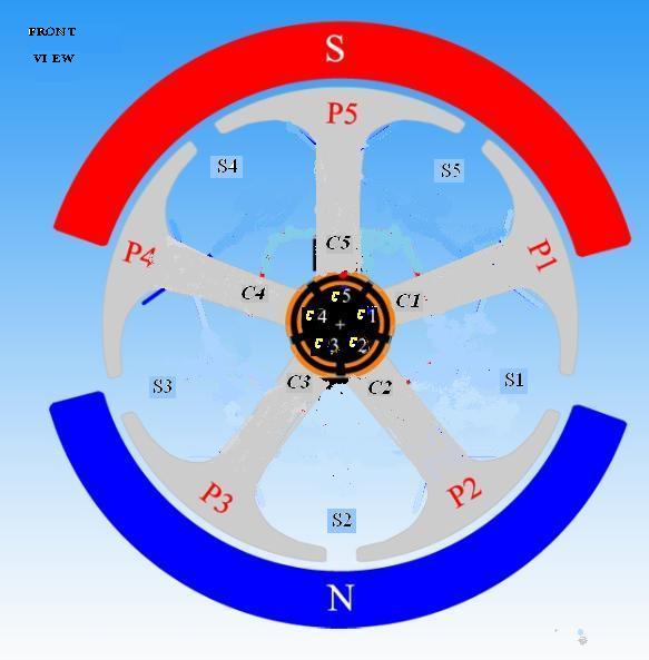

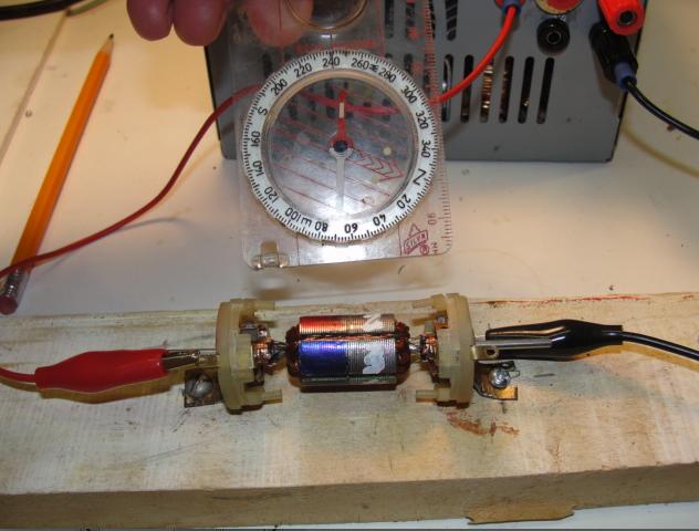

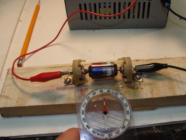

            • Attacking the RS winding
              Fantastic info on winding guys, let me post some more results I have and get some more responses on my toy motor while you guys try to built that home power plant. What a dichotomy!
              So here is my favorite picture on how to wind a 5-pole motor asymmetrically.
              Before I can write intelligently about my findings, let me set out my annotations:
              Commutator annotation C1 would indicate the front commutator and c1 (lowercase) the back commutator in alignment with C1. This will be called the front view.
              On the last winding, the only one that you can reasonable inspect with a very good magnifying glass I am certain I went from commutator C4 up to Slot S2 and wound CCW ~40 turns around Poles 1 & 2, and then transitioned to CW winding around poles 4 & 5 coming out very nicely to commutator c4.
              In the unannotated winding diagram, it starts at P1 and crosses under to Slot S4, wraps CCW around what would be Poles 4 & 3.
              Subtracting (P1 - 2 = P4) from all these numbers confirms and matches this diagram. So apparently I am OK at least on the last winding.
              Now lets look at the polarity. The diagram shows its pole 1-2 as a south pole. But I hook up +3 v to the C4 commutator and it does show the opposite, North Pole. I have to read Mr Stone's post to see if I can find some understanding on polarity. I think I read somewhere that the Left-hand rule is applied with the fingers identifying the current flow the thumb should be North. I just get confused about it being the opposite direction of the actual flow of electrons though??? But the motor doesn't really care it will just turn the other way? But in any case I think my pole is a North pole there not South.
              Poles 4-5 with this test jig is not very accessible but this seems to get satisfatory results showing the opposite pole there, South.
              Other windings seem to respond the same as I rotate the rotor.
              So does anything seem incorrect so far to anyone?

                    • Rs-p5
                      Originally posted by sampojo View Post
                      OK, so impedance between coils runs from about 1.5M to 5M ohms, thought I saw an 88k once or twice but could not reproduce it. Just had the Ohm meter on leads between the motor and generator coil. Between any coil and the rotor or shaft I go no indication of any sensitivity in the meter, total open circuit.
                      So should I just tear the motor down and try again? I re-used the old wire which had the nicks in it at all the old commutator locations. I saw an interesting post around page 50 saying you should use 32 gauge if you want to put an asymmetric RS motor amp range down near what the amp range of the symmetrical motor. I could try that as I would like to modify a home appliance I have that uses this motor and I think it would be too powerful. I am interested in the longer battery life it should give.
                      Thanks UFO!
                      Hello Sampojo,
                      Don't take it apart...run it...take it for a spin Man!!
                      According to all your pic's, and tests...it should run great now!
                      [IMG][/IMG]
                      After assembled...it should look something like this Uh?...
                      Ufopolitics
