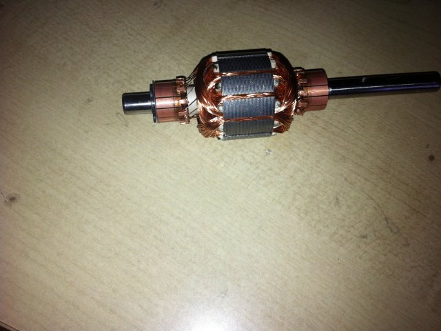

            • Kogs update
              G'day All
              Last week I finished winding my modified mobility scooter I put it together and connected 12 v to it and it spun OK I was a bit cautious as the last windings wound were very long at each end and I thought that perhaps if I continued to test with increased speed they might throw out and destroy the motor so I balanced it and epoxied the armature.
              Now when I ran it today it would not even move I pulled it apart and tested for a short it seemed OK but the ohms reading this time shows .4 where as when I wound it the Ohms I am sure was between .6 and .7 It looks like I will have to pull it apart again even the thought of that is escaping my mind as I have tooo many things to continue with
              Here is the pics of how I progressed
              Mobility Scooter Photos by Kogs1 | Photobucket
              You notice the 2 pack putty I used to balance with
              Kindest Regards
              Kogs
