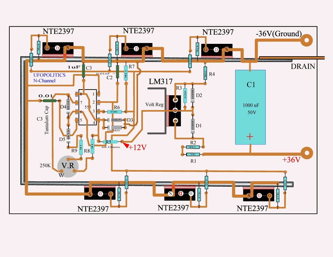

ONE MAIN THING KOGS, PLEASE!!
Do not forget to Install from the MAIN POSITIVE CABLE TO BATTERIES A KILL SWITCH...AND make sure you would have VERY EASY access from your driver seat...Remember, when FET's go bad...they normally do it by shorting out Source to Drain...meaning "RUNAWAY DRIVING"...You have N-Channels...so killing must be done by cutting off POSITIVE from Batteries...NOT Negative!
Do not want to hear that Nessie crashed, because of just one faulty FET!!
SECOND: Make sure that you test ON BENCH FIRST all this connections (if you want to do them, of course) BASICALLY the FIRST GEAR , in order to test your controller stress to "take it" since it will do, reverse very high spikes.
