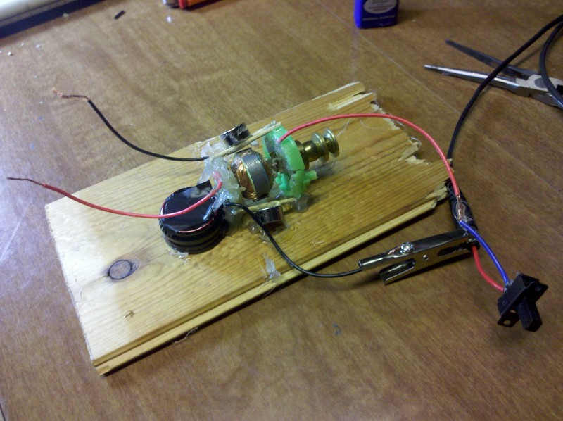

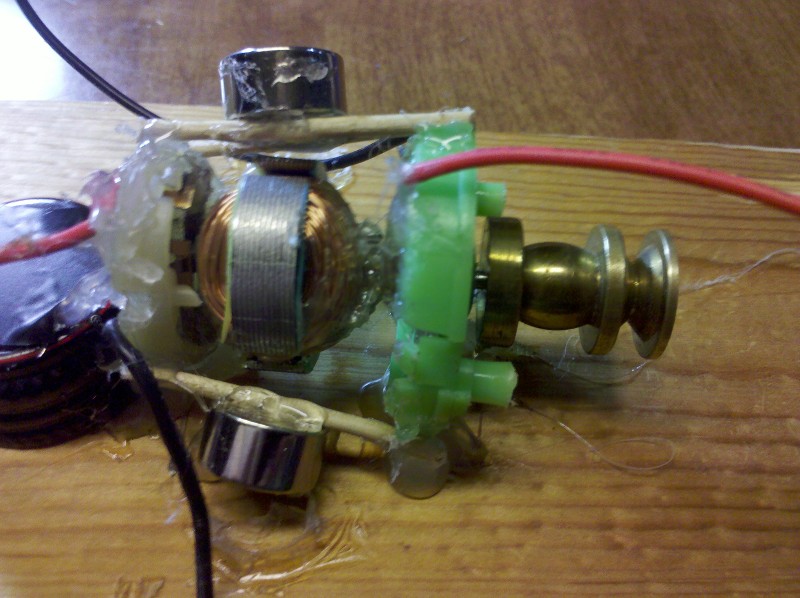

              • glu-i-uth
                Hey everyone,
                Little messy looking because of the hot glue but it runs great.
                3 - Pole, 26 awg bifilar, and a pair of 1/4x1/2 N52 neos. Hopefully it doesn't vibrate itself to pieces before I get my next motor built. Little trouble with the commutator starting position like was talked about but it's getting a lot better the more I run it, one of the commutators is keeping a brush from making contact by keeping it elevated. I damaged it while trying to make sure the commutator sections didn't short to the case when I lost one of the teflon washers... oops. At least the toothpick magnet supports are holding strong.
                Despite it's shoddy construction, and slightly uneven commutators on one end, it really does run well, and starts most of the time now, just a tap is all it needs if it fails on it's own. If it ever ends up in an RC, I'll just be sure to always park it on a hill.
                peace,
                matt
