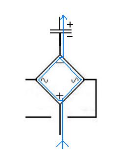

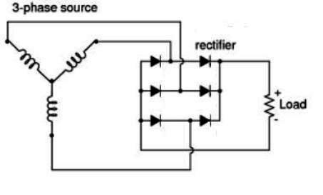

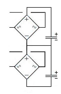

                      • hi citfta. this might help with feeding additional coil outputs to the storage cap.
                        the blue lines and arrows show flow from - to + for the first coil and either polarity input to the ac legs is additive, in voltage, to the 1st coil's.
                        maybe another fwbr is required to rectify the 1st coils output on the front of this, or maybe try splitting the 1st coils output like you would do a voltage doubler,and run 2 strands of fwbr's. or maybe you have to take phasing into account, or maybe rectification and smoothing of each coil's output is required. lotsa maybe's but it might be worth trying different combinations.
                        also, for y connected motor coils, a common scheme for car alternators looks like it blocks cross currents, phase to phase,effectively. easily expandable for more than 3 phases and available in 1 block component for 3 phase.
                        pic 4 is a nifty adaptation.

                        • I have pondered on Carroll's problem with connecting the two DC outputs of the two diode bridges in parallel: basically the problem is that he has two different voltage sources and these can only be connected in parallel if the inner resistances and the output amplitudes of the sources are identical. If you connect a 12V and a 12.5V battery in parallel for instance, the 0.5V difference will drive a charging current into the 12V battery and this is a load for 12.5V battery. Maybe such a 'load' appears in Carroll's setup for one of the output coils?
                          The best is to use a scope and explore the phase and amplitude issues.
                          Perhaps a simple solution to separate the two voltage sources is to insert a diode in series with the DC output of one of the diode bridges. This diode could block any loading effect by the other source. Such series diode is used at the outputs of solar panels to prevent their backloading effect towards the batteries when there is no sunlight.
                          Voltan's second drawing is correct I think and should give a solution too, however the DC outputs are added in series. IT is true that the individual DC outputs are available too but with a common + and - connection.
                          Gyula
                          • Hi voltan,
                            Thanks for your suggestions. I have tried connecting the separate coils to individual bridges and then connecting the output of the bridges to the same cap. That is when the system bogs down. If I connect them to different caps then the system runs fine. However I can connect the outputs of both bridges back to the run battery and it does not bog the system down.
                            Gyula,
                            I think you may have it figured out. There is a difference in voltage from the coils primarily because of my crude set-up. I don't have all coils mounted exactly the same distance from the rotor and of course I don't have the phasing exactly the same either. I did take a quick look yesterday with the dual trace scope and did not see anything that looked out of the ordinary. So I think you are right the problem is probably just a mismatch in voltage causing one to feed the other. It is kind of strange I don't get that effect when connecting them both to the same battery but the capacity of the battery is so large it probably just absorbs the charge and doesn't allow any to feed back to the other coil. I need to try with a larger cap and see if that makes a difference. I will try to do that later today if I have time. I have another unrelated project I am going to have to take care of that will keep me tied up for the next few weeks and will not be able to do any testing after today. But I will be back at this as soon as possible. And I know Dave is also working on the pump motor coil generator idea.
