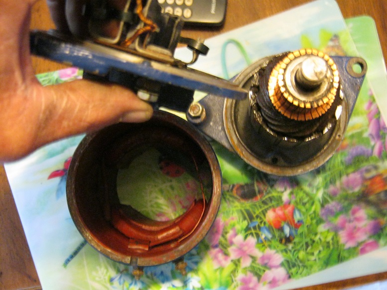

                            • Hi folks , I got this generator at a yard sale 5 bucks.
                              The field coils are connected in series I think.
                              The armature has 28 comm section and 14 core faces, is that what you refer to when you say "shoe"?
                              Also the case serves as a common ground??
                              This is the generator I was asking about earlier, I'm not sure how to connect it?
                              The brushes seem to be grounded right to the lid, but one brush has a layer of insulation between it and the lid , where the other doesn't?

                              I attached a photo is this an old school generator?
                              artv

                                If I understood mbrownn what he was calling a shoe is the center of the field winding. He can correct me if I misunderstood what he meant. Your generator has two field windings so it would be considered a two pole generator. He gave a link in one of his earlier posts on this thread where he goes into some pretty good detail about what he has been doing. I have read through it once and need to read it a couple of more times to get as much as I can from it. As far as I know he has spent more time and effort on understanding the Lockridge device than anyone else on this forum. His method of sending the generated current back through the driving armature is pretty slick. I am still working on understanding just how he did that. His knowledge of how to use BEMF to an advantage is well beyond my understanding of it. I am looking forward to learning more from him.
