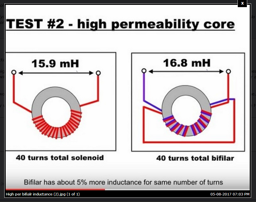

                          • Allen's math
                            I had started using evostar's thread again as I thought Allen had chased him away but evostar is back using that thread again so I will post this here out of respect for the OP.
                            Originally posted by Allen Burgess View Post
                            @bistander,
                            I made the point that a more tightly wound coil would generate a stronger field than a sloppily wound coil of equal wire gauge and turns for the same input. Lets say the difference in inductance was 5%. We could equal the strength of the sloppy coil with the tight coil by reducing the input by 5%, right?
                            Lets say we feed 10 watts into both coils: We would gain 1/2 watt in savings, right? 100 watts would result in 5 watts savings and 500 watts would result in 25 watts savings, got it?
                            My power input calculations result in a savings of that amount with that amount of difference in inductance between the two types of coils. You say I divided when I should have multiplied. Your approach would throw the answer off in the wrong direction by an "Astronomical Parsec".
                            I was asked for a simple explanation: Greater inductance results greater efficiency, got it? Your math is really stupid! Stop acting strange.
                            16.8 mH divided by 10,000 equals 168 Gauss
                            Which is: 0.0168 / 10000 = 168.
                            I say that is wrong and that 0.0168 / 10000 = 0.00000168. So I came to the logical conclusion that Allen meant multiply instead of divide. Because:
                            0.0168 * 10000 = 168.
                            Silly me. Allen insists he is correct and I am wrong.
                            Then another example of Allen's math skill can be found in this recent post of his:
                            The inference you make that the tiny wire connection between the bifilar windings accounts a huge 1.9 mH difference in inductance is ludicrous. See the High Perm inductance measurements below:
                            Allen subtracts 15.9 from 16.8 and gets 1.9. Or "16.8 - 15.9 = 1.9"
                            I wonder if Allen can see his error and actually admit he is wrong. Probably not.

                              The only real difference in the bifilar series connected coil and a normally connected coil is the added capacitance of the bifilar coil. It also makes no difference if the coil is a pancake coil or a normal solenoid type coil the extra capacitance is still there if the coils are bifilar. Several tests were done on the OU.com site that confirm this.
                              The added capacitance of the bifilar wound coil is that it allows the coil to be resonant at a much lower frequency than a normally wound coil. As was pointed out on the OU site at the time Tesla was working with high voltages and high frequency, capacitors that met those requirements were hard to make and so Tesla was looking for a way to make a coil resonant without the need for capacitors and thus came up with the bifilar wound coil. Now high voltage capacitors are fairly easy to come by so the need for bifilar wound coils is not as great. They are still an interesting device for studying resonance and especially for learning about inductive and capacitive reactance.
