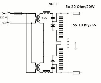

                      I'm using two MOT's to power it like this drawing below but the clip was done
                      without the filter. I've got some problems to overcome. And my frequency is 760 kHz.
                      But I expect to be able to power the setup with anything from about 50 Watts
                      to a few hundred when I'm finished. The DC resistance of the secondary and
                      extra coils is about 3 Ohms. About 48 meters in each. Like you I'm kinda
                      working alone to my own beat, which is how I like it.
                      Sorry about the rough drawing it's a working sketch.
                      I can provide the coil specs later when I make better measurements.
                      P.S. The leak point was a 2.5 mm ball of solder on the end of a piece of wire.

                            Your MOT power supply is very similar to mine, but I have added a voltage doubler just like they use in a microwave oven. Say 1 MOT gives 2000 Volt, that would be about 2800 Volt peak to peak. Doubled makes 5600 Volt and because I have 2 MOTs I end up with 11200 Volt. Then I put 5 10nF2KV caps in series, parallel to each diode of the doubler and a 100 Ohm resistor where you have the coils between the 2 spark gaps.
                            Works well, but the MOT's get very hot. probably because I do not (yet) have the cap (9 uF) in series with the primary.
                            Oh, I also have the MOT's parallel instead of in series, in such way that their secondaries are 180 degrees out of phase.

                              My power supply is not yet fully proven, I do intend to go to "anti parallel" as well.
                              But to explain my intention with the cap. It's a Tesla tip from the CSN.
                              The 9 uF cap is just big enough to get just close enough to resonance with
                              the two MOT primaries in series so that enough voltage is produced to fire
                              two 1 mm gaps. With less than 9 uf they won't fire properly. If the MOT
                              primaries are put in parallel the resonance is not needed and would require
                              more capacitance to get it if I wanted it. That cap in series with the MOT primaries
                              somewhat reduces the current possible I think, especially in a short circuit
                              situation (arc trailing). The input with the spark gap firing depends on
                              the frequency of the spark discharges, I think the gap can fire and the MOT
                              primary capacitor can be discharged then recharged several times in each half cycle.
                              I'll need to make some modifications before I can actually measure the input
                              power without using a battery, it's only really important to me to determine
                              the efficiency.

                              • #90
                                Just now that I have found my duo MOT power supply schematics, I noticed that you added the coil parameters. I will have a look at that later. Here's how I have connected the MOTs.
                                As I said before I need to reduce the max. current a bit, and I am thinking of putting a cap in series with the primaries.
                                I am not sure if my set up interferes with TV reception. 1st of all we have satellite tv because I am living outside of the civilised world, second the sound of the spark gaps firing is so loud that that alone makes it impossible to watch TV.
                                Just like you, I have 2 spark gaps. One is part of the HF filter, and shown in the attached schematics, the other one is part of the primary circuit and is not shown here.
                                More later...
                                Ernst.
