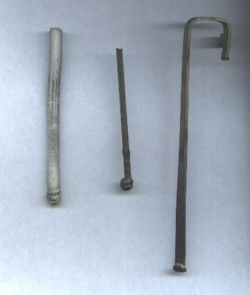

              • Calculations asked.
                Can somebody say how many watts and how long it takes to melt titanium ?
                And maybe also from aluminium and stainless steel ?
                Enlarge this pic 200% to see the dimensions of them.
                With your technical skills this must be an easy task for you.
                • Originally posted by Hobby Eon View Post
                  Easy indeed, if only I knew just how much titanium was melted, how hot the not-melted part had become and how much titanium was involved.
                  Example:
                  suppose we had 10 ml titanium of which 1 ml melted and the remainder gained half that temperature.
                  1 ml titanium is 4.54 gr has reached a temperature of 1940 K. (melting point) starting from 20 C that is a temperature rise of 1647 K. It needs 520 J/K.Kg so that is 3888 J.
                  9 ml titanium is 40.86 gr has reached an average temperature of 970 K, a rise of 677 K, so 14384 J.
                  To change to liquid an additional 20.9 KJ/mol is required. 1 mol is 47.867 gr so we have 0.0948 mol requiring 1982 J.
                  So we need a total of 3888+14384+1982 J = 20255 J.
                  1 Watt is 1 J/s so if you would apply 20 KW, it would take little over 1 sec. Supposing no energy is lost elsewhere.
                  You can do the same calculations for other metals and or quantities.
                  Now, I only wonder how this relates to Wardenclyffe.
                  Ernst
