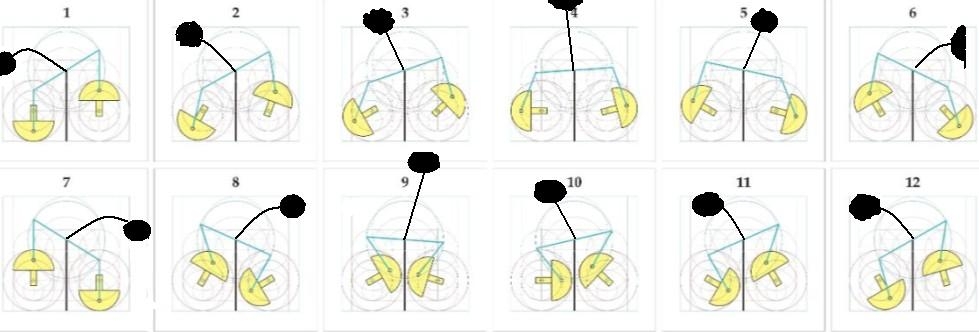

          UCROS pivot
          Here is the updated version, you can easily see this will have a asymmetric velocity profile. Regards Arto

              Hi Artoj,
              I first ask you to forgive me for my mechanical ignorance if the following idea is deemed stupid. I wondered if adding an inertial mass supported with a semi-rigid rod to the lever of the UCROS mechanism would increase the output power of the device? Is this principle taken from the Peruvian device applicable to the UCROS machine? Does gravity or the inertia will assist with the rotation?

                I think Ucros' and Fernando's machine are in some sense equivalent and that the working principle is the transfer of inertia back and forth.
                I think it does not matter where the mass is locatedm whether in the wheels or on the top of the connecting arm. Just the sum of all inertias is what matters. But I could be wrong.
                I think the same effect could be achieved by using 2 flywheels
                and some elliptical gears like these:
                Cunningham Industries, Inc.
                since the output speed of the second gear is variable.
                What do you think, could the same velocity curve of counterrotating wheels linked by an arm be achieved with the right gears ?
                Would the gears endure the constant material stress? (dynamic load).
                It would be interesting to build a small prototype and seem how it works.
                Are good CNC shops able to make those elliptical gears?

                  Good work
                  Thanks Arto, that looks good. Sort of in answer to Aaron's question, Ucros does show a model with counter weights on the beam.

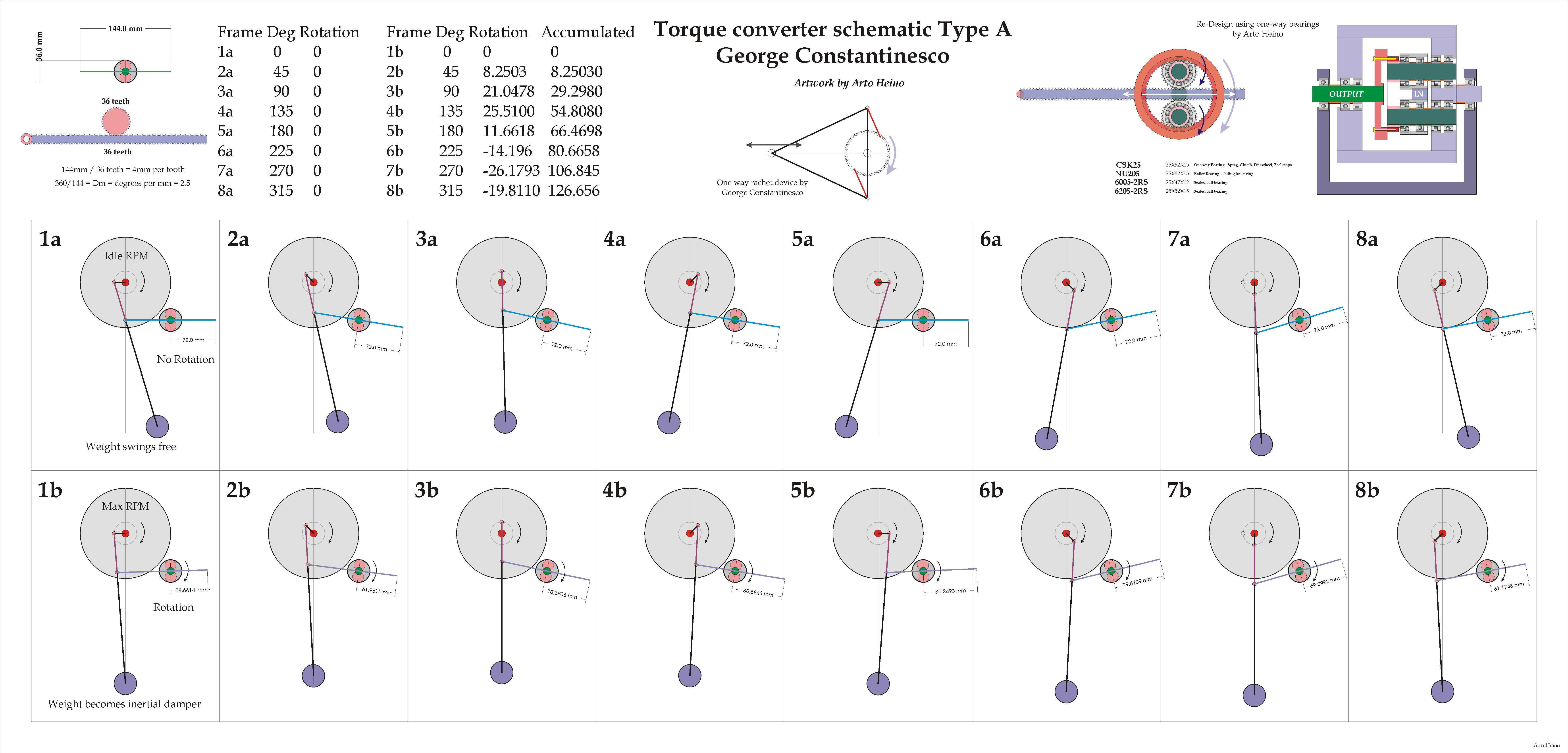

                    George Constantinesco
                    Hi members, I thought I would include a sheet that might help those who need to understand the simplicity of concepts that George Constantinesco has imparted to engineering history. This is just one of many conceptualizations and actual machines he did over his lifetime.. He helped develop the sprag clutch bearing which I included in the picture as part of the one-way mechanism that is essential to the workings of his torque converter. His initial design drawings were a gear and double pawl mechanism that transferred the linear motion to rotary motion. Regards Arto
