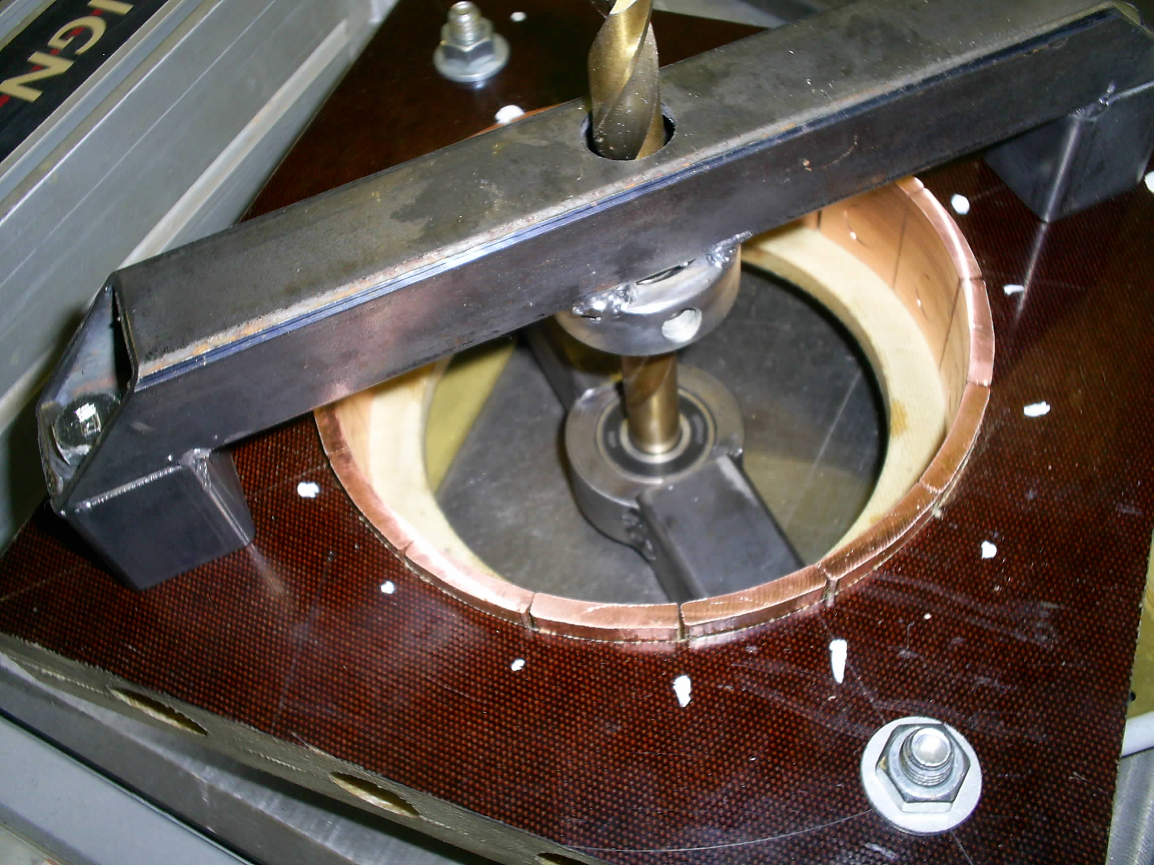

Yes you are right , perhaps we should absolutely stay in your descriptive design as per your excellent drawings, but as you can see in my very first video, i was very near from the original Figuera with gap and rotating commutator, and got no significant results. I mean for me a real increasing of the output power on the secondary. I am probably making something wrong?
