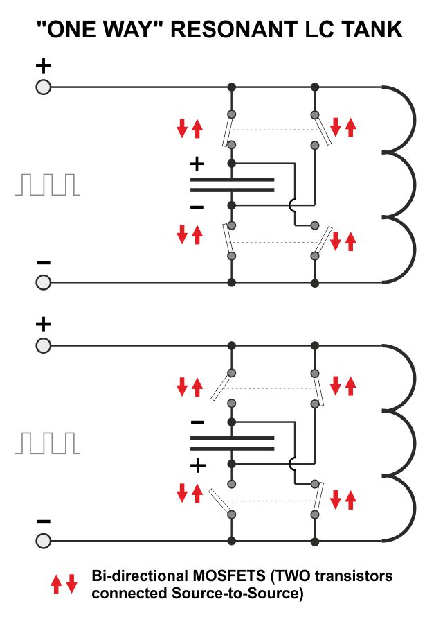

              • OK. I need some help.
                I've been thinking that if we could build an unidirectional resonant LC tank on both primaries it would benefit the design.
                NOW. The question is:
                How to make a switching circuit, that after a one way discharge, when C reverses polarity and a flow of current falls to 0, the circuit would FLIP the capacitor's polarities,
                so instead of the current to go backwards it would go the same direction once again.
                ANYONE?

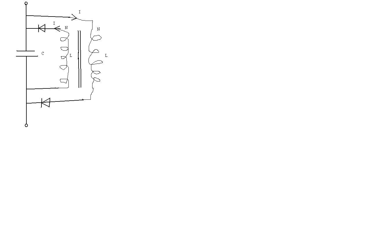

                • Not flipping plates, flipping L!
                  Originally posted by kEhYo77 View Post
                  The question is:
                  Hi kEhYo77,
                  I would suggest not to flip plates, but use two L on one core. Each L does half the job. See attachment.
                  Best Regards
                  magnetO

                      Hi,
                      my L-C-L is only the first of figueras primary (primary N). We need a second L-C-L for the second figuera primary (primary S).

                        2. It might not work the way You think... When C is discharging and current is maximum in one coil, the BEMF instead of filling up the capacitor to its full potential will start 'leaking' through the other coil... Don't You think?
                        • Originally posted by kEhYo77 View Post
                          @MagnetO
                          OK, now I see it, but:
                          1. It requires twice amount of copper to saturate the core this way. Flipping a capacitor by switching might be cheaper especially for larger setups
                          1. Yes! No clue of how to switching plate!
                          2. I did not built it yet. But now as You say: When current was max. in one L and goes down, polarity of the other L is switching (to S), diode gets contacting, both L run out, C empty ....... Would only be worth a try, when both L NOT magnetically coupled. Two different cores for one figuera primary (N)

                              • And here is a solution to my problem! A plain H-bridge won't cut it...
                                I think I've got enough transistors (16!), drivers(4) and optocouplers(4) to do the One Way resonant LC switching for both coils. This should be interesting... Some heavy 'U93' ferrites are waiting.
