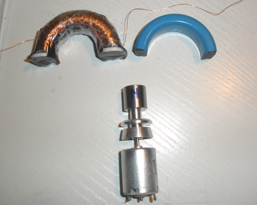

                        Hi Vidbid
                        Thank's for sharing this info on the "motor -generator"
                        So i had some time today to replicate this experiment
                        So i cut one of my big ferrite torroid in 2 parts, and wind one half with 700 turns of 0.3 mm copper wire (11 ohms DC resistance and 39 mH inductance ).
                        Than i fixed a diametric neomag cylinder (i got from a high quality Faulhaber motor ) on the shaft of an electric motor. And made some testing.
                        But the result is a nice sine wave on the scope under no load, and clearly Mister Lenz is operating when i short cut the coil. Almost double Amperage with load versus no load.
                        So i tried a lot of speed, but no way to get the acceleration and decrease of power when the load is connected.
                        I remind that my core is in ferrite, and perhaps the "secret" is in a plain steel core . But no succes for me so far.
                        And an other experiment and learning.
                        Good luck at all
                        Laurent

                          Hi Laurent,
                          Perhaps the distance between the magnet and the half core also counts, I mean the ratio of the magnet diameter to the (inner) diameter of the (half) core: your magnet seems to be big in this respect (if I compare it to the setup shown in the second video).
                          Perhaps if you happen to have smaller magnet, about half sized in diameter compared to the one in your picture, also magnetized diametrically?
                          (The closer the magnet to the core, the higher the Lenz effect becomes.)
                          Regarding steel core, it must be laminated because otherwise eddy current losses do occur, your ferrite must be good in this respect. I hope the core shown in the video test is not a solid iron (even if it is soft iron, it should be laminated).
                          Regarding your load, you may wish to use a 10 Ohm resistor instead of the the short circuit, perhaps it also helps seeing the effect. In the second video the input current changes i.e. reduces very little: from about 1.0 - 1.01 Amper to 0.99 or so for the unloaded - loaded case, this may indicate a narrow operational window for the effect I guess.
                          Thanks, Gyula

                            Hi Laurent,
                            Very good experiment. Thank you for sharing your experimental results with us.
                            In terms of a generator, it is truly a mystery at this point.
                            By the way, I am thinking of an experiment for my Flux Containment Module.
                            Kindest regards,
                            Vidbid
