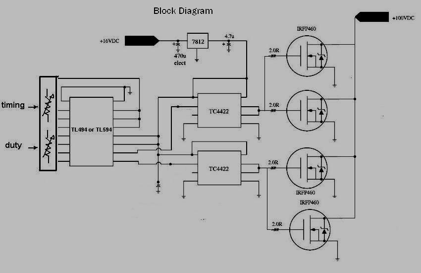

New Block Diagram
Hello Cap Dump enthusiasts.
Here is the direction I am going building a capacitor discharging unit for zapping batteries. First of all I need to point out the main important thing about this diagram and that is the MOSFET NUMBER.
IRFP460

Here is a more sensible design for running a voltage of 100vdc.
The IRFP460 has a decent amp handling capacity yet has a voltage limit that will handle inductive kick backs. This has been found out the hard way with my circuits going up in smoke.
If it works don't fix it! right? Well that is right and I am throwing all of my IRFP250's back in the drawer for lower voltage projects, after all they are good parts when used the right way.
The circuit that is underway.

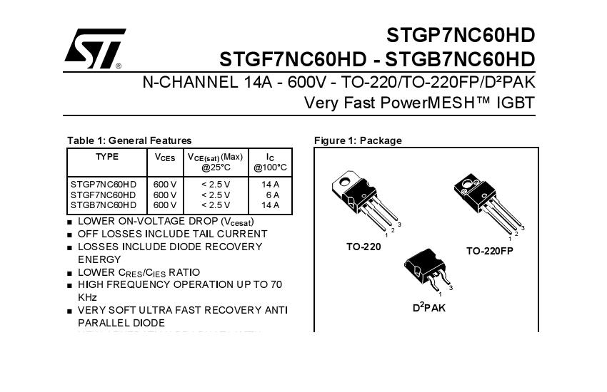

The whole point is that to pulse 100vdc a 600vdc max rated part is selected so anyone pulse charging a 36vdc battery should never use a 200v device.
This only one of many versions
This motor is used for most and a 14 amp part at 600vdc usually 5 or 6 devices to handle 800watts.

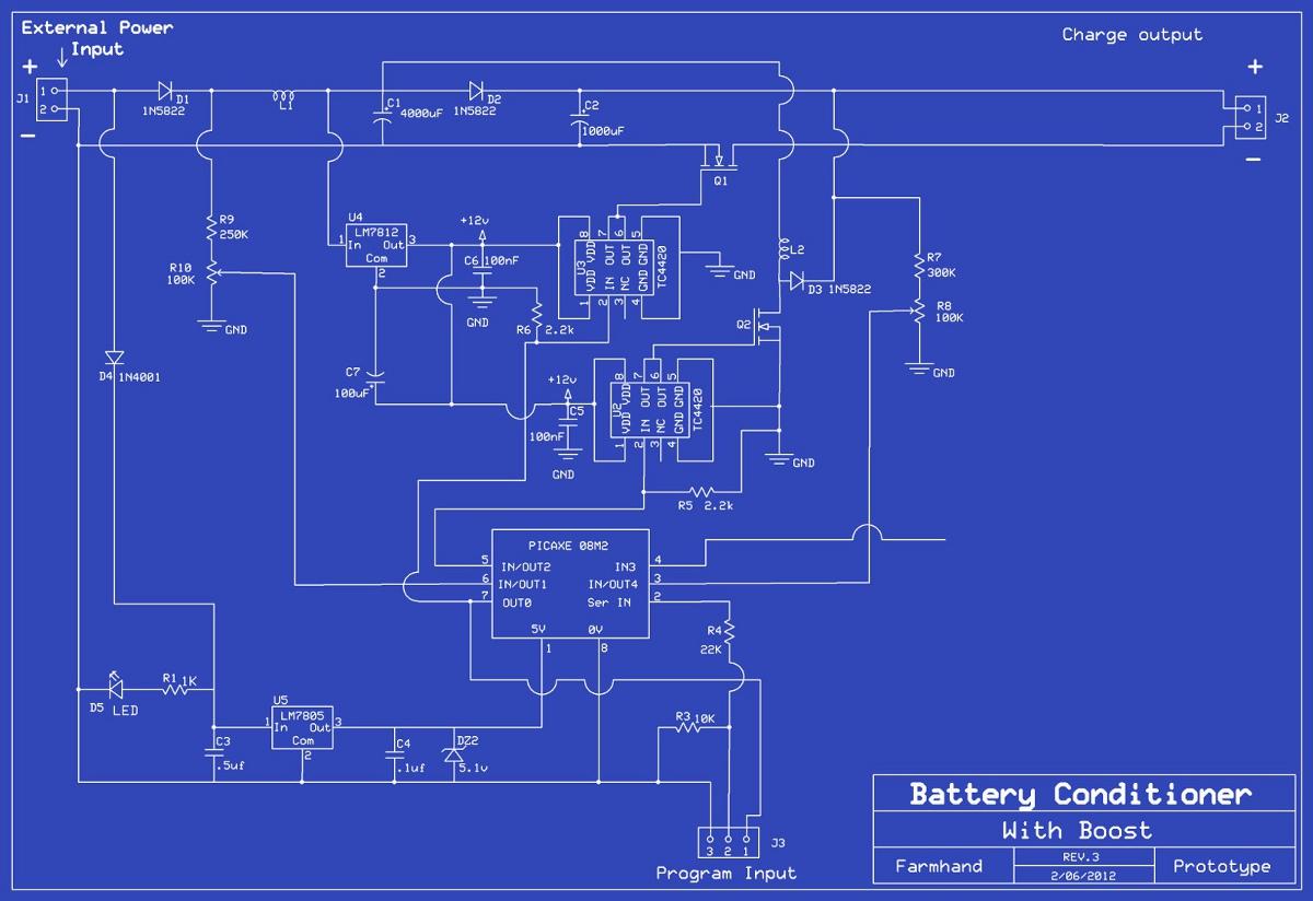

circumstances cannot post here any more. I also attach the circuit I made up
for conditioning batteries. I don't think I posted it yet.
The question of rise and fall times is good. The actual rise and fall times cause
a period of resistance change through the switch from high to very low, the
faster the rise and fall times the less energy is dissipated by the switch resistance.

My circuit is designed to do both desulfation and charging based on a solar input that varies in power and voltage.
However it can be used with a 12 volt battery for the supply where it will
then use one mosfet "Q2" as a boost converter to charge C2 cap to whatever
voltage is programmed then "Q1" dumps the increased voltage to the battery,
in a series of 10 to 20 microsecond pulse trains. It pauses the boost
converter while the cap dumps happen.
With solar input it's programmed to pulse the battery so as to keep the solar
input at it's max power voltage of 17 volts if solar input goes less than 17 volts
then the boost kicks in and 24 volt conditioning pulses are supplied to the battery.
