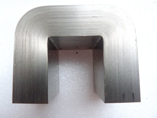

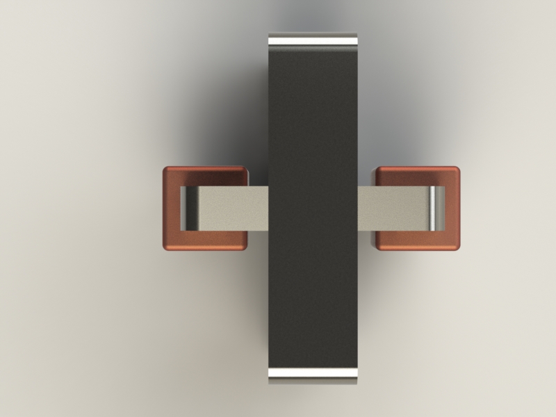

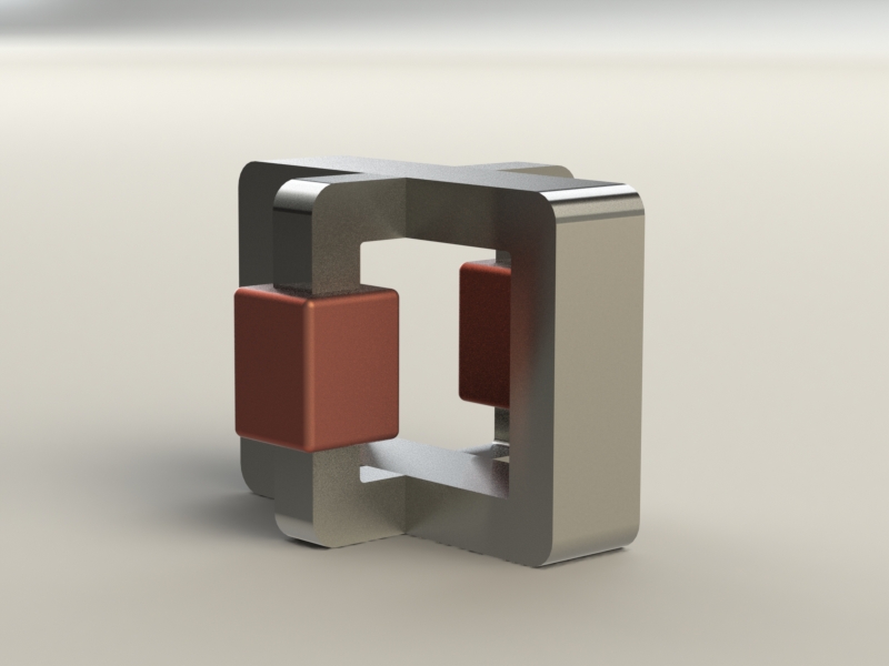

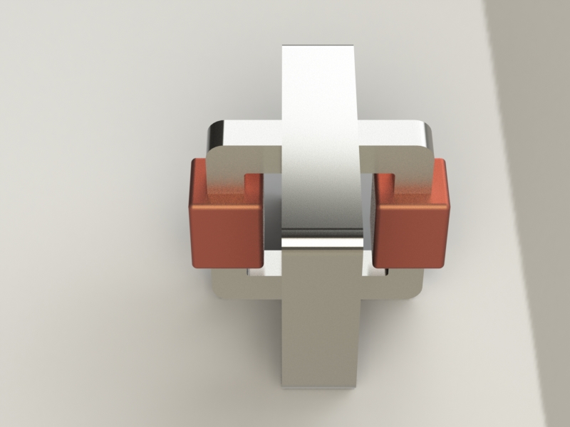

                          • C cores are very cheap things to get, especially from Alibaba suppliers who are sometimes even willing to send custom made free samples (if you can convince them you'll be buying many).
                            In my opinion this effect remained for too long in the mW and perhaps slight W range. Noone has ever took this to even near kW range due to core and design limitations. This could be easily solved by using cut low loss amorphous C-cores that are readily available. Attached is such design example.
                            What this design doesn't show is the extra cut line, so essentially the C core is cut in half again in order to facilitate the insertion of the coil AND the equalization of the reluctance of the flux path.
