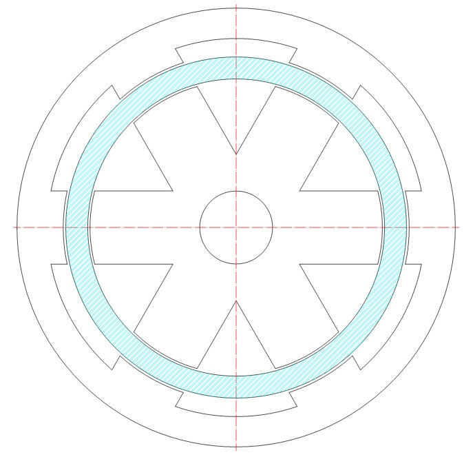

        • This is what I am building. Syair gave the design to us.
          It's been known for almost 200 years that if you take a bar of iron and put two magnets with like poles at each end, the fluxes will combine and produce a more powerful opposite pole in the middle of the iron bar.
          An electromagnet will produce a magnified flux in the center line of the poles while little flux will be present on the exterior of the electromagnet.
          Winding the coils to present opposite poles towards each other when induced, and redirecting the electromagnetic flux parallel to the iron rotor will give an attraction and a repulsion to the rotor at the appropriate times.

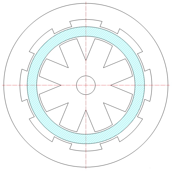

              I like it a lot Cadman, but at the moment with only two snapshots, all I see is the pole flipping of the iron bars. I can't see the flux changing in the outside stator core.
              If you would, can you maybe show three or four snapshots with some more annotation showing direction of rotation for the iron bars and how the flux is changing?
              Also, do you think your design is limited to four poles? Could six or eight work equally well or better?
              Attached are some templates I drew up to scratch on with pencil. Hopefully they are useful.
