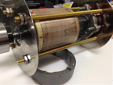

                      • Take a razor scooter motor all apart. You will be using just the case and the magnets inside it. Heat the case until the glue comes loose to get the magnets out, or use some solvent to get them out. Now get a piece of plastic pipe or cut some circles out of wood or almost anything you can put a shaft through the center of to use as a support to hold the magnets so that they form basically the same circle they formed when inside the case, only a tiny bit smaller so that you have clearance between the magnets and the case for your air gap. The case will rotate around the magnets that will be held in place by whatever you have built to hold them in place that has a shaft through the center of it. The shaft goes through the center of this contraption and is supported on both ends.
                        Now take the case. The first thing you are going to do is mark some large rectangles on it that you will be cutting out to allow the magnets that will be inside it to "see" the coils that will be on the outside of it. Mark these rectangles and use a metal cutting blade on a Dremmel tool to cut them out. They should be filed and sanded when finished so no jagged pieces of metal stick into the air gap and hit the magnet when it is spinning.
                        Next, cut two circular pieces of plastic that will fit in the ends of the motor case. Each piece of plastic needs to have a hole in the center of it large enough for the shaft that is going to your magnet holder to go through without touching. to make sure of this, and to make sure everything is centered, I would put two small pieces of pipe on the shaft that will also fit in the center holes in the plastic circles you have made for the ends of the motor case. Assemble the whole thing and spin the motor case. If nothing hits the magnets when you spin the case, it should work.
                        At Lowes they have a circular piece that has threads in the middle and four bolt or screw holes around the outside designed to hold iron (gas) pipe to use it as railing. I already have two of them from the railing on my back porch that I replaced. You need two of these that will hold a piece of 3/4 inch pipe. Screw in a two inch iron gas pipe nipple into one, and a three inch nipple into the other. You center one over each hole it the plastic circles on the ends of the pipe case and bolt or screw them in place. The shaft that holds the magnet holder will come out through the center of each one of these. On the shorter one, put a bearing. On the longer one put a pulley and a bearing. Your motor will turn the pulley and this will rotate the iron motor case around the magnets. Now you have to build something on each end that holds both the shaft of the magnet holder and the bearing of the motor casing so the shaft is centered in the nipple that has the bearing on it.
                        Now you need a piece of plastic pipe that is slightly larger than the motor casing so it will slip over the motor casing and you can wind your coils on it. I am thinking of using a piece of pipe that is basically the same size as my motor casing. Cutting it in half or in quarters, depending on whether I want two coils or four coils. Then laying a piece of thin cardboard on it to form the space for my air gap. Lay it on a piece of wood and secure it in place. It will be curved up in the air from the flat piece of wood of course. Drive a row of finishing nails into the wood on each side of the piece of plastic, and wind the wires back and forth around the finishing nails going across the cardboard which is on top of the plastic. Once the coils are formed, I could epoxy the wires all in place, pull out the finishing nails, and I have my coils to put around the outside of the motor case. If the are on the plastic you should be able to just slide the whole thing over the motor case.
                        That's basically it. The only hard part is finding a piece of plastic pipe that is just s bit bigger than the motor casing pipe. I will be looking for that. That is the simplest and most "off the shelf" design I could come up with. Rip it apart guys. If it won't work, let me know. I'd rather find out now than after I spend good money to build it.
                        Dave
