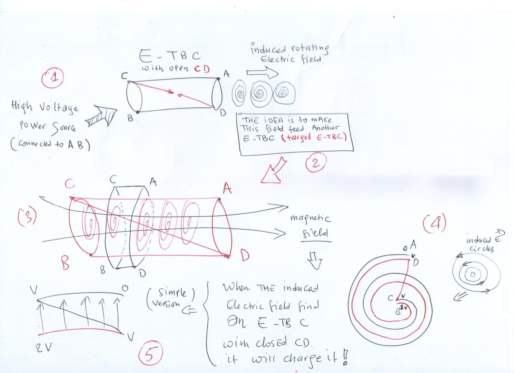

          i don't have a scanner at this moment- i use paint.net to draw my idea, i think it's better to use my hand but the idea is very simple, you asked this :
          Code:
          What is the Excitation one and what is the main one??
          if you have two E-TBC just put one inside the other ! the larger one have to be fed in resonance, just put your spark gap in CD position, now this is the excitation coil, the main E-TBC is the target coil because it will receive the induced electric field only, it's an open circuit, the magnetic field will not be degraded but we need the induced electric field generated from the excitation coil, ok ? is this difficult ? if this coil will oscillate because it will be charged we don't need to connect it to anything, it receive the power , the capacitive side will be charged and after that it oscillate, it's the main E-TBC because the junction CD is closed there why we have to close this point? because it's the current path, without closed CD there's no electric current produced.
          don't be confused, just ask gain if you don't understand, soon i will put some drawing, even the previous posted one is very simple also!
          you see the excitation E-TBC with open CD ok? your high voltage source is connected here, now put another E-TBC inside the first, this is the main resonating coil, again with a closed CD, this will ensure the induced field will build a difference of voltage in the main E-TBC, when this is done, it will oscillate and pump the power, at this point just put your L2 coil to receive the power, if correct combination is used this system will give the sing of power ! if you are not able to do that, just wait until i do the test and share the results!
          when i talk at this forum i am thinking loudly, at least i can hear the echo of my voice !

                  • just a simple drawing to explain the idea !

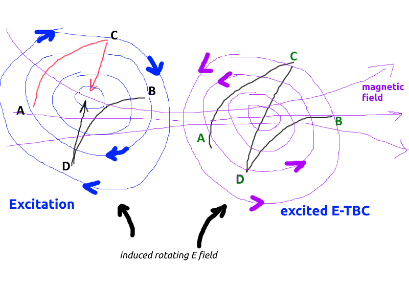

                          • this was just an idea but after examining the idea thoroughly there's no need to change the orientation of main E-TBC because it will see that magnetic field as if it's produced from the main E-TBC itself, whatever the orientation of the main E-TBC the magnetic field from the excitation coil will be seen if it's produced from the main E-TBC, when the magnetic field start to collapse the two magnetic field must be oriented to the same direction even though one will increase ( main E-TBC ) but the other will decrease ( excitation E-TBC ), here the question if one will produce a CW rotating electric field while the other will produce a CCW electric field the two field will cancel each other or at least a weakening will happen ?! what do you think ?
                            • Hi to All ,
                              i was thinking about the last asked question about the induced rotating electric field generated from both E-TBC ( the excitation one plus the main E-TBC ), in reality it's a difficult question regarding the geometry where they interact with each other especially the behavior of electrons in both coil..
                              i just divided one mixed E-TBC to form this experiment, the main E-TBC is charged with the induced electric field as expected but still further experiment have to be done to know exactly if this method is appropriate or no .
                              • The following drawing show the addressed problem, maybe we could find a solution by using an appropriate length, so maybe it's better to use a small length for the excitation coil with this the magnetic field zone will be small..
