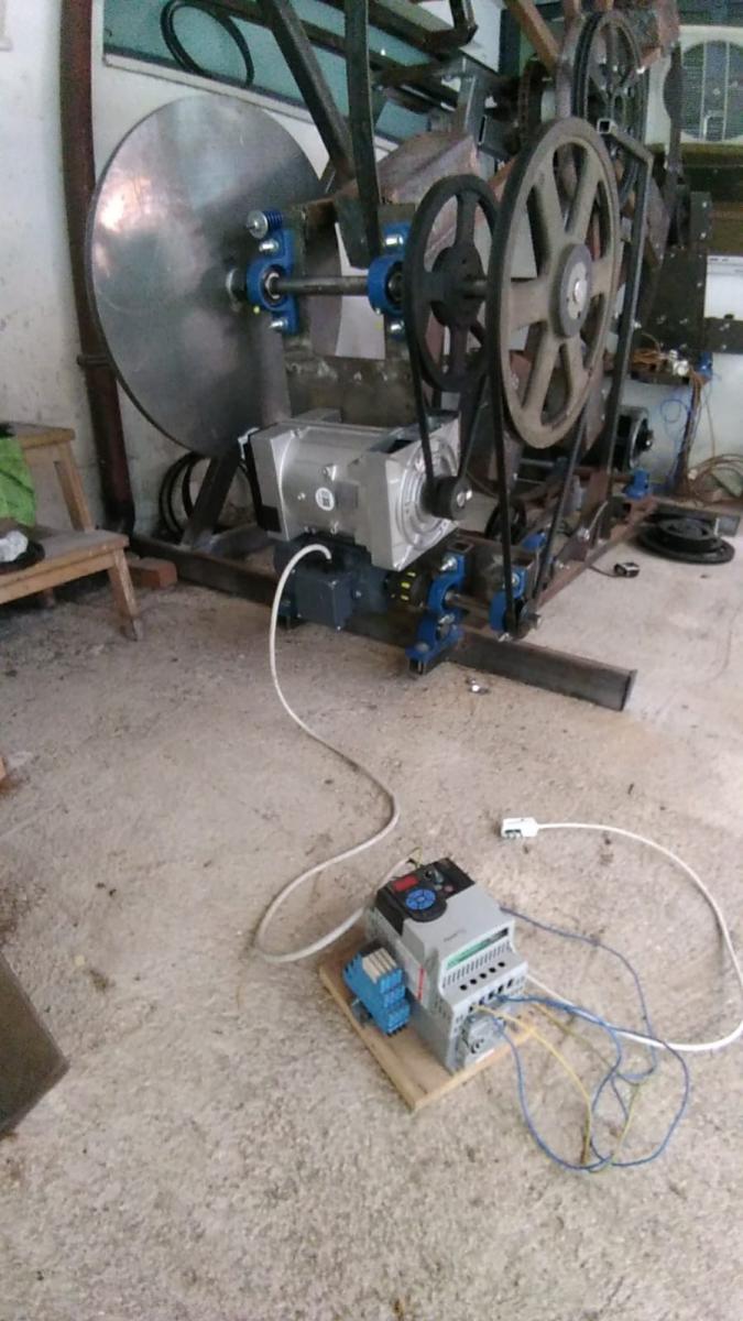

      • thank you for the advice, I could only upload a photo to show the test, I used a 1hp engine and a 2kwh generator, with a 40kg flywheel. Click image for larger version

          Nice test stand.

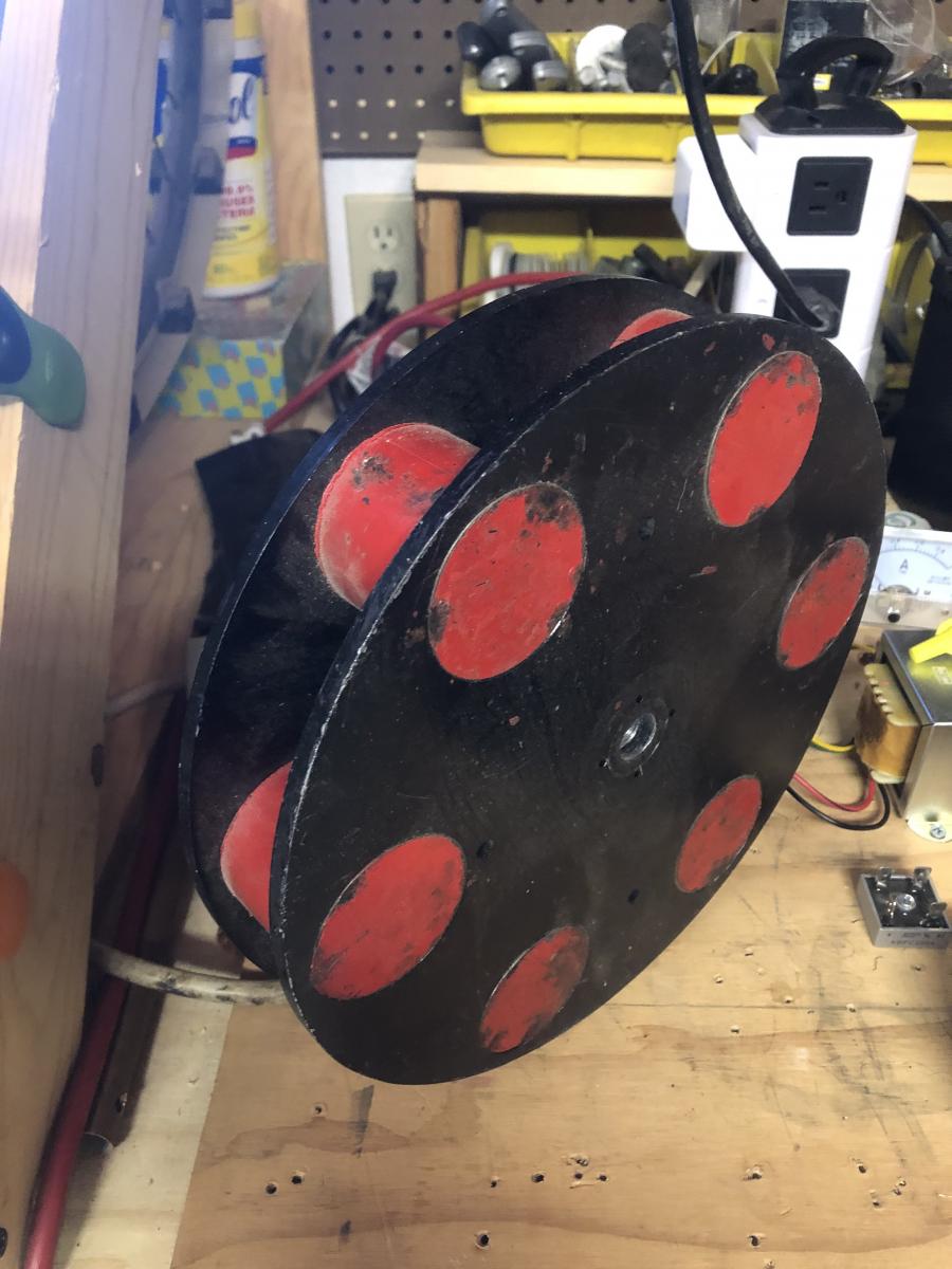

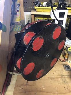

                That is a beautiful test bed. I can only imagine how much time, effort and $$ went into that. Back in the day I built a much more compact version. I had no room for a flywheel that large so I used two metal disks with 4” holes cut into them. In the holes were 4” diameter pieces of pipe filled with lead from old window weights, fishing lures, and whatever else I could find. Each piece of pipe was filled and then weighed. The lightest one became the standard, and all the others had some lead drilled out to match the weight. If you drill out too much you melt some more lead and fill the hole back up. Attached is a picture of a smaller version I have that goes on my generator shaft. Click image for larger version  Name:	6FE7AF0C-13F6-4A8D-BA46-FF1A32D5A8FB.jpeg Views:	0 Size:	107.5 KB ID:	508439

                      • Turion I am fortunate to have a lot of passion, time and opportunity, having space and an equipped workshop available. I would like to try to replicate your project, (at the moment I am replicating the homopolar generator of Trombley-Adams), what kind of coils should they be?
