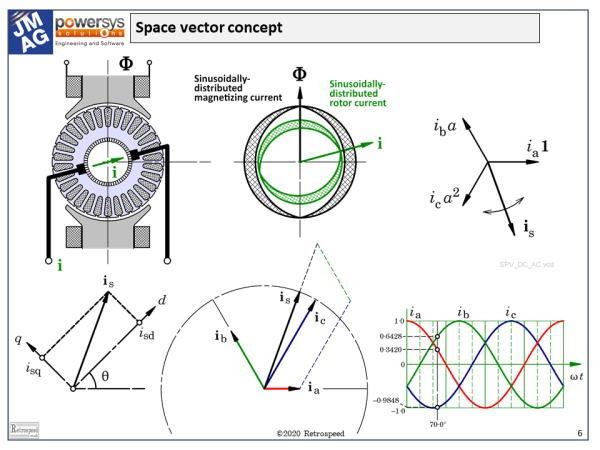

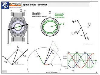

For those interested in understanding this video, read https://www.jmag-international.com/engineers_diary/021/Originally posted by Rakarskiy View Post

Yes, that's exactly how they teach it, but the second excitation option does not simulate the current in the closed windings of the armature with collector-brush commutation. When commutating with restarts, there will be mutual induction, pulse transformation.Originally posted by bistander View Post
But the essence is correct, if we rotate the brushes around the armature collector, we will get a condition under which there will be no mutual induction, but there will be generation.

It's the other way around, like a locked rotor test on an induction motor, a test engineers do in the lab at university and in industry.will get a condition under which there will be no mutual induction, but there will be generation
Generation is the conversation of mechanical energy into electrical energy and it doesn't occur without physical motion, the displacement between two bodies between which exists force (work being done).
