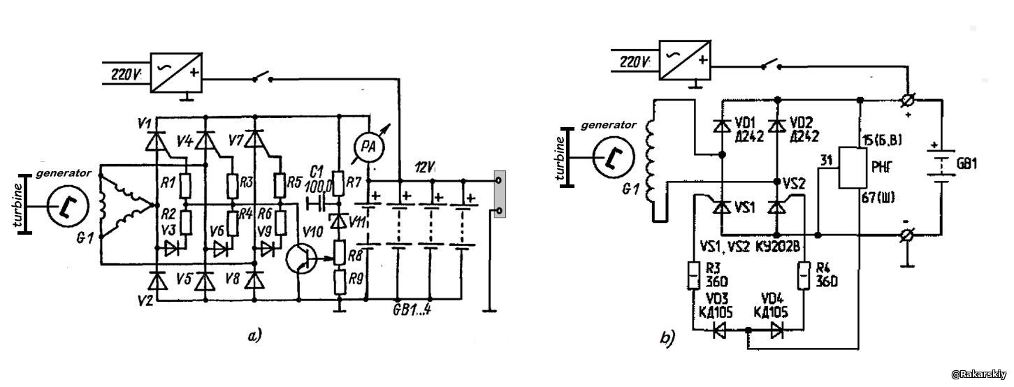

    The voltage at idle (no load) was 60-65V, and the battery voltage at which the charge occurred was 24V. So, the thyristor was given a switch-off signal when the voltage reached 27V, which corresponds to a full charge of the 24V battery. Before that, where did the rest of the voltage, or rather the EMF, go?

    • You clearly have a perception problem. You are confusing the whole thing (isolated circuit with the household network via distribution transformers). Under load, on the capacitor will be the voltage that remains after voltage drop and current generation in the isolated circuit I am considering.
      This sketch is based on motifs from Soviet technical specialist magazines, variants of adjustable rectifiers for permanent magnet generators, which I did for an amateur group on building mini hydroelectric power plants.

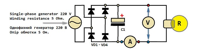

        Mr. Rakarskiy,
        This is the circuit where you blundered. What is the voltage V across the load R which is also across the capacitor C1?
        It is in your published essay found at the address above. You conclude and state:
        As a result, we get a constant voltage of 220V on the load.
        That is incorrect. Connected as per your diagram, the load voltage is NOT 220V when the circuit input is 220VAC.
        Address this issue. Or perhaps you do not care about the quality and correctness of your publications, which you offer for sale. How do your customers feel when you ignore uncorrected errors and mistakes the likes of which you've been informed?

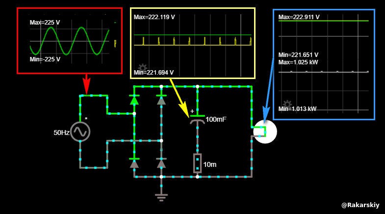

        • bistander, What are you looking at? Your socket? If so, you don't understand how the power grid works, from the alternator at the power station to your socket.
          The case I am considering is very clear: when the load is switched on, the voltage across the capacitor terminals will be equal to the voltage to which the total induction emf falls from the generator winding to the load. The voltage at the capacitor terminals will be equal to the voltage measured at the load terminals.
            I am looking at your example here:
            From:
            You say
            we simulate a circuit with an alternating generator, the current of which is rectified through a diode bridge, we also plan a capacitor C1 in the circuit, which acts as a storage device for smoothing pulses. As a result, we get a constant voltage of 220V on the load.
            That is incorrect. Look it up. I gave you 2 references explaining FWBR calculations. You insist you are correct and millions and millions of us are wrong. It is a simple circuit. Hook it up and measure it for yourself. I have used and measured FWBRs hundreds, likely thousands, of times. The text books are correct. At the load you'll see approximately 310Vdc depending on the ripple (size of cap and current).
            • You are referring to your socket, where the connected phase is separated from the three-phase network, not the network I am considering, where there is only a generator phase and a load phase. Therefore, in a three-phase network, it will be calculated differently. Secondly, I gave the formula for calculating the capacitor below in that post.
              And if you do the full calculation, you will have more places where you will not understand why. All electricians in power grids consider a source with zero internal resistance value.
              I really doubt your professionalism. It would be easier for you to act as an observer. It is very difficult for me to change my mind about something, especially with references to impractical training materials, when I have experienced everything first-hand.

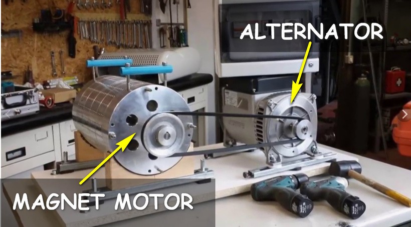

              • MAGMOV LOW COST ELECTRICITY GENERATOR PRODUCTION - YouTube
                The company from GEORGIA has been offering a domestic power source for five years. The rotor of the generator is driven by a magnetic motor of a special design. Unfortunately, I have not been able to find any information about the happy owners of this source.
                The presentation video personally raises questions for me.
                The three automotive generators are designed for a rated speed of 5000 rpm. At what speed must the linear magnet switch move to provide at least 1000 rpm of the drum of magnets that is connected to the generators. Second, a contact of two points on the magnetic pole of the drum, about 1 cm in diameter, unclosed by magnetic interaction, can develop the appropriate torque to turn the three rotors of the generators in the boost mode?

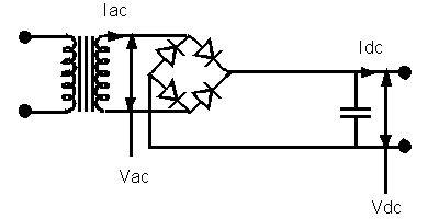

                  This is the network of your example. That's it complete.

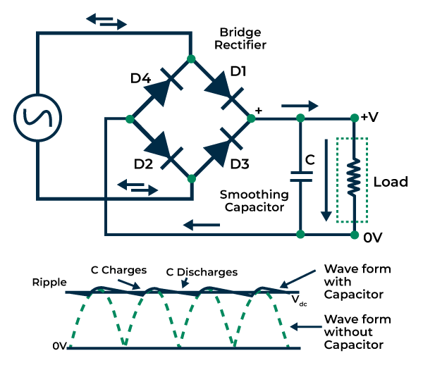

                  Vac = Vdc x 0.71
                  That is the correct relationship between AC voltage and the resulting rectified filtered DC voltage
                  Look it up.

                      This is what you showed:
                      The symbol for the source with ~ indicates sinusoidal AC and convention is and always has been that the numerical value, 220, is the RMS.
                      It is a poor, underhanded attempt now for you to imply that you intended for the 220 value in that diagram to be the peak of the AC voltage, which yields 156 V RMS. What country's utility grid supplies 156 volt electrical service?
                      Also, you begin the paragraph using that diagram with:
                      we need to know the current strength for a load of 1 kW at 220V: P = UI from here I = P/U = 1000 W/ 220V = 4.545A
                      To calculate the current from power and voltage necessarily implies the use of RMS values. 220V is the RMS value.

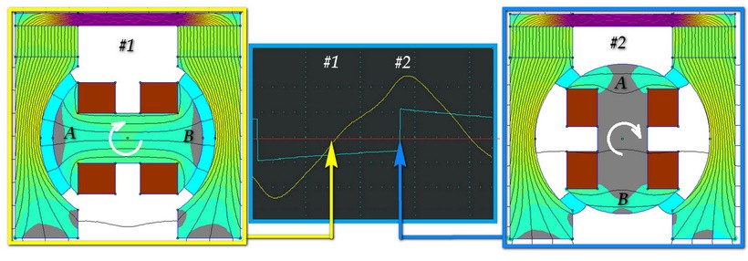

                              As usual, it's nonsensical and reflects some basic misunderstanding. But I'll stay with an obvious math error in this post, found in this paragraph
                              The largest value of magnetic induction is 1.699 Tesla, this is in the iron bridge between magnets with a cross-section of S = 25 mm 5 mm. In addition, this is the only place where all the lines of force of the magnetic circuit pass. Thus, we can determine the Magnetic flux Ф = Bm S = 1.699 T (0.025 m * 0.005 m) = 0.000125 Veber.
                              Next, knowing the switching frequency of 20 Hz and the number of turns of the armature coil (500 turns), we can calculate the no-load EMF (without a connected load) based on the transformer formula of EMF:
                              E = 4.44NФf = 4.44 * 500 turns * 0.000125 Veber * 20 Hz = 9,42945 Volt
                              I myself did not expect such an exact hit,
                              Notice in the equation below,
                              You neglected to multiply by 1.699 and simply used the product of 0.025•0.005 for flux. Correct value of that equation is 0.00021webers.
                              This affects calculated voltage in the last equation.
                              • Notice in the equation below,
                                Thanks for editing, I did make a few typos in my haste, but it doesn't change the essence.
                                I added another slide where both anchor positions are fixed and in both the function of cutting the anchor wires by magnetic lines is impossible.
