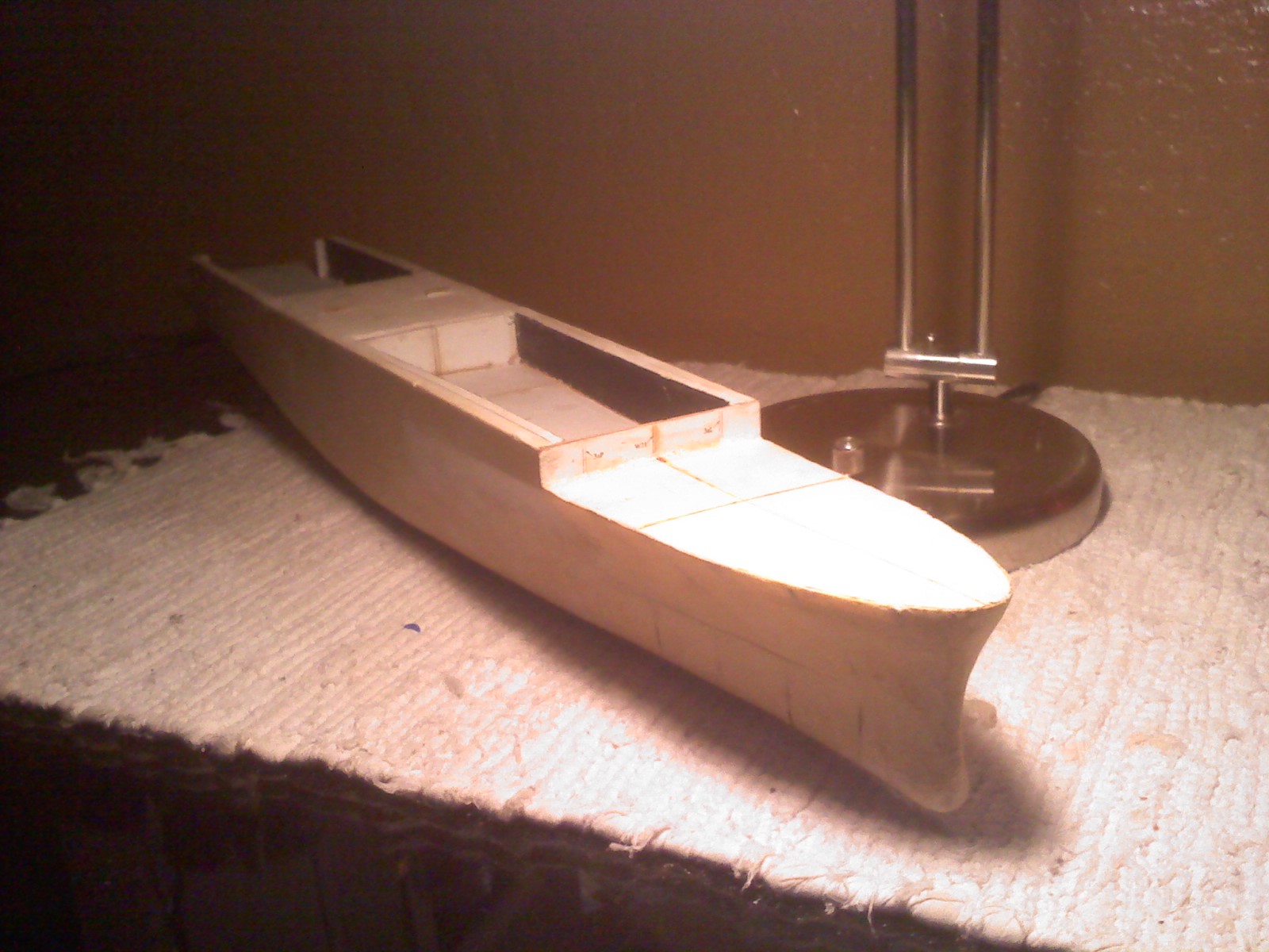

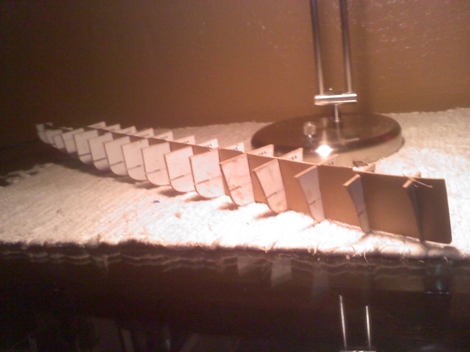

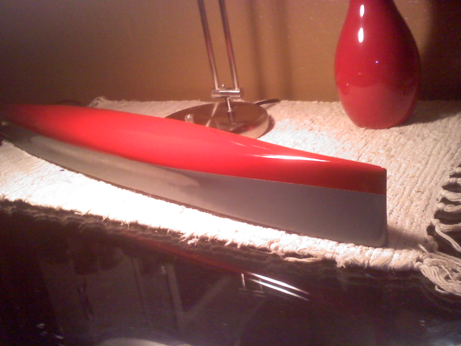

          Here's what I would recommend. Use foam like the pink or blue house foam to create yourself a form you want. Begin by using some cardboard to create a circle and which is about the size you want your saucer. Then divide the circle in to parts. Say 3 or 4 parts. Now you have a base pattern for a mold, and which you can then use to lay the paper mache up on once you carve the shape out of foam. In this way you are making 3 or 4 parts that you link together later to complete the model, so you don't have to make an entire saucer mold. You only need to make a portion of it. Understand? This is why you divided the circle in to parts. The paper mache process easily links these parts together. This way you can then create the 3 or other parts and then link those together. You could do this to create a test model hull, or to create a complete saucer shape in order to further refine the saucer hull to use as a plug for a production mold.
          I put in a couple attachments of the process I've used to make some model boat hulls. I can tell you that a very fine finish can be achieved, and which is hard and durable. It may actually be superior to fiberglass in some respects.
          What I did is to use Tightbond III waterproof glue spread by hand/fingers on wet news print. You don't really need that much. Just a milky watery consistency will do fine. The main idea is to impregnate the paper with glue, and again you don't need that much. I just ran water in the kitchen sink, and then pushed the paper in for a few seconds, then removed it and laid it on the counter where I then used a squeeze bottle to run some lines on glue across the dripping wet paper, then using your fingers you work that around to impregnate the paper fibers.
          I can tell you this works amazingly well, and not only that, but the materials are free, biologically safe and sane. About a 10 thousand % improvement over working with polyester or epoxy resins.
          Once this drys you can sand it and then give it a diluted covering of glue to seal it. I did this on the boat hull in the attachment. I then went further and used lite weight spackling to fill and refine the smoothness, again I gave the hull another light covering over the areas which needed covering and then sanded the hull again to further refine the smoothness. Finally I gave it a coat of paint, allowed that to dry, then sanded and filled any imperfections with autobody glazing compound. This really is the final word in fine filling. Once that was all cured a final fine sanding was done and then a layer of paint, after which this was repeated a couple times to achieve a high gloss finish.

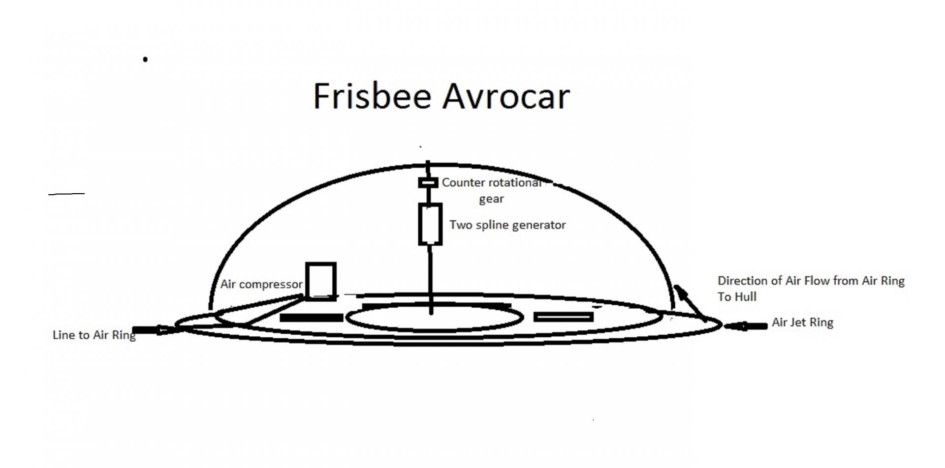

                  Frisbee Avrocar
                  Here's a drawing of a new concept that couples the spinning hull with the Avrocar air jet nozzle ring:
                  The air is compressed by tiny motor connected to a two sided drive shaft electric generator I included between the main drive shaft, and blown over the spinning hull from jet air ring around the base from the lip upwards! The design includes a counter rotational gear:

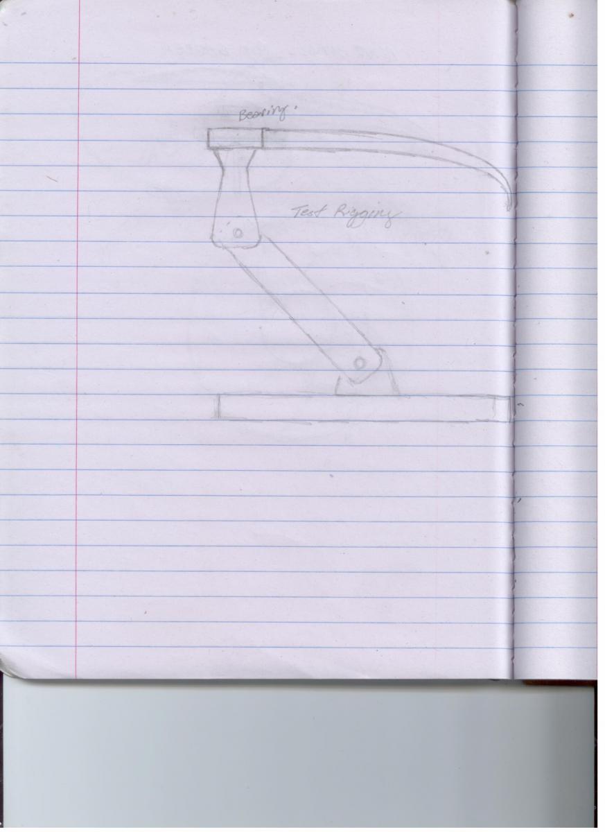

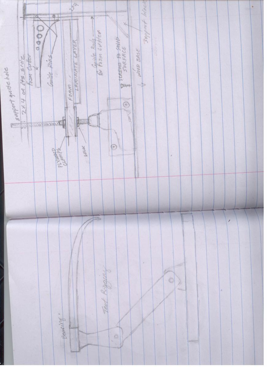

                          I spent the day thinking about this so called gaget mall saucer BTW. This resulted in the following.
                          I sketched out a test platform for a saucer. This would just hold the center solid using a bearing and the base would be weighted/clamped/staked so as to keep the saucer from injury by flying off. Simple arrangement with one axis of movement for now. No provision for a fan at all. The entire idea is prove that blown wind will spin the saucer as described, and that the spin will result in a lift potential.
                          I sketched out a cutter for a saucer to create a uniform shape from foam. A simple wooden block cut to the profile of the airfoil is all that is needed. Then glue some 80 grit sandpaper to that and lower it on to the spinning foam core. A secondary duplicate block with a 220 grit will produce a fine finish on the foam.
                          I considered the lift potentials in relation to the known qualities of rotor craft. A wider saucer should enable a low powered motor to produce enough airflow to allow flight: Akin to early under-powered airplanes using a larger airfoil. Therefore an alternative to more power is a wider stance, or greater diameter saucer.
                          I considered directional control systems. I thought about a swash plate mechanical control system, and then realized we don't need a swash plate.
                          Affirmative Control by mechanical linkage is possible with a Kaman Helicopter style servo-flap rotor. https://www.helis.com/howflies/servo.php
                          Alternatively experimentation with the JNL One atmosphere plasma control system may itself be incorporated in to a hull and also function to enhance the airflow.
                          A couple very ruff sketches.

                              Gambeir sketch
                              @Gambeir,
                              I resized and rotated your sketch. Good work! This will earn us a DARPA grant!
