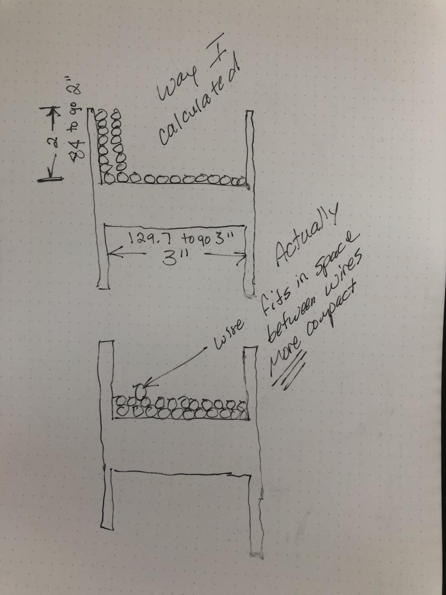

I do not know number of turns per coil. I've never counted that.
If you look in the far right column and go down to the bobbin that comes 245 to a case, that's the one I am using.
15/16 is the the outside diameter of the "tube" the coil is wound on. 3 1/16 " in length between coil ends. Outside diameter of the coil (wire) I wound is 3".
I will have to run the machine again, get you a screen shot, measure with an RMS meter and get the RPM all at the same time. I did not output full voltage from the coil for the video because all you asked for was a wave form. If full voltage output is important, let me know, otherwise I will basically do what I did before. I might have to reduce some things to get the full wave form on the screen at full voltage output. And it really WON'T be full voltage output since I never run it faster than 2800 RPM, although I have had it up to 4,000 just for fun. It may not be until much later tonight. My wife is working from home today so I try to not run things while she is in the office right next to my shop.
