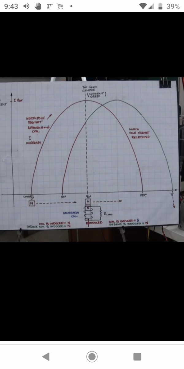

                      Here look at what Thane has been saying for over 10 years. This is the way we build a
                      Gen, build a gen, build a Gen, this is the way we build a Gen so early.............
                      You'll all catch up after about another ten.

                      Doesn't the zero crossing align with TDC? Not the way Thane shows.
                      • And the answer is: Yes and No. Simple huh? What Thane shows is probably for a specific Setup he is using or demonstrating.
                        if you have paid any attention to what I’ve said about this hundreds of times, which you obviously haven’t or you would know the answer, ... Lenz is a reaction that takes place, not some arbitrary “Law”. WHEN it occurs is dependent on core material, capacitance of the coil, mass of the core, and frequency (rotor speed plus number of magnets) so WHEN it happens can be adjusted. You can use it to create a small motoring action or a LARGE motoring action, but you sacrifice coil output as a generator coil to get either and sacrifice MORE for the LARGE motoring action. So the “reaction” that is Lenz May happen BEFORE TDC, AT TDC or AFTER TDC depending on the adjustments YOU make.
                        you can use it (Lenz+coil) as a BRAKE, a GENERATOR or a MOTOR, but you must choose which and design accordingly. By the way, imagine a motor composed of coils whose capacitance was controlled by switches and microprocessors. Imagine what could be accomplished by instantly being able to switch between those three.

                        • I'm talking about the red curve; the one for the conventional coil.
                            Don't get it? That's because Thane is way ahead of the curve, see you in ten.

                              This graphic was chosen by Thane ( likely drawn by him) to use as the premise of the argument which he presents in the video. The red curve represents load current versus rotor position for the conventional coil. As shown in the simple schematic below the graph, load current is same as coil current. His graph depicts maximum coil current at TDC, top dead center or when the rotor magnet is aligned with the center of the coil. This is wrong. When the guy begins with and uses a false premise, his argument falls apart. This is evidenced by his narrative, part of which I transcribed here.
                              2:56
                              When the rotor magnet moves past the coil
                              2:59
                              Past top dead center, past the current crest
                              3:06
                              Now the current flowing in the coil changes direction. The induced magnetic field from the coil turns into a South Pole.
                              3:19
                              And the coil resists the rotor magnet departure away from the coil
                              3:24
                              He says the current changes direction as it passes TDC. Clearly his graph contradicts this. In fact, his graphs shows nothing but positive current. If it is positive on both sides of TDC, it does not change direction through the coil thereby according to his premise visual aid, the coil does not change polarity.
                              The video is nonsensical. As are his other videos. In one of the last two posted by BM, Thane claims a battery electric vehicle using his coils will charge its batteries while driving and then discharge its batteries when parked delivering power to your home or workplace.
                              Now I see where Turion claims that effect seen by using multifilar wound coils, namely delayed Lenz, I presume, can be obtained using conventional coils with capacitor(s) across it. That should be easy to demonstrate. Anybody with a magnet rotor, coil and capacitor care to give it a try?

                              • Now this is how we know you don't qualify to judge any of these processes. You must be able to read the map for the wave forms like any 9th grader. Sorry BYE your inabilities are showing up again.
