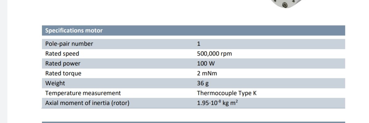

People quite often seem to think they can beat Lens. Million rpm motors are about which are practical but it's also possible to spin a ball up to many millions of rpm.
https://pes.ee.ethz.ch/research/rese...-Motors-1.html
