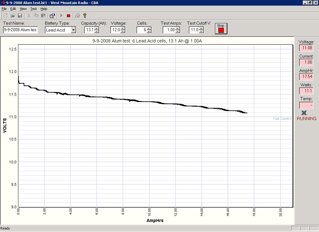

              Load test results.
              After my 3rd cycle with this battery I have 17 + amp hours starting at over 12V down to 11V. As I understand from my reading it takes about 10 -20 cycles for batteries to get their full power. I may just stick this into my car so it gets good cycling. This is a deep cycle battery so that is why I took it down to 11V. ( normally don't like doing that ) Note this was with a 1 amp load.
              It is giving much better load tests than it was before.
              It is now charging to 14.5 V at 8 Amps conventional charge. To me this is a success!!
