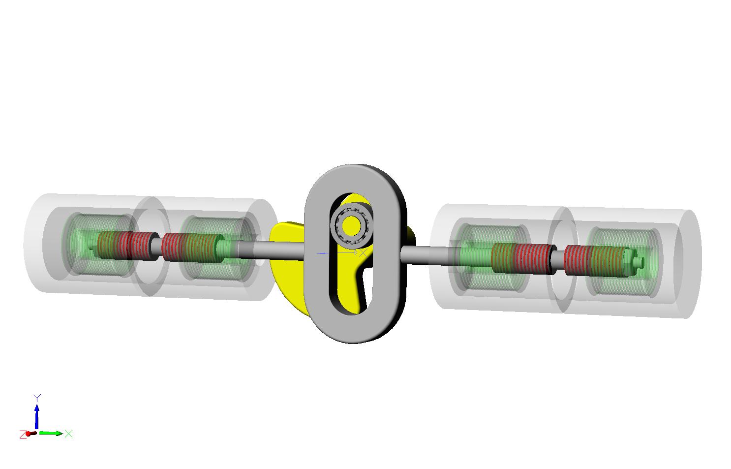

Scotch Yoke
Carl,
If you are interested in the Scotch Yoke setup, I'd recommend posting a question to David here:
An optimum geometry of the Scotch Yoke setup has been figured out by Bourke, who simply had the best Scotch Yoke setup, ever. By geometry, I don't mean the concept in general, I'm talking about the ratios of relationships of the parts between each other.
I understand I don't know what I don't know so there could be some of Bourke's engineering that might apply to his engine that might not necessarily apply to the solenoids....however, David would be the best to kick those ideas around. He has probably the best blueprints and maybe the only ones...for this as he actually has a Bourke in his possession. They are for the engine and the Scotch Yoke setup isn't unique to Bourke but David offers a great resource and I'd recommend checking out his site thoroughly to get a deep feel for the whole concept.
If anyone else wants to kick around ideas about the mechanical engineering part of the Scotch Yoke...might be best in this thread:

I'm with Peter on this one because I anticipate few obstacles that would have to be solved.
1. One shouldn't use two solenoids per yoke because one would really want to use keeper in order to minimize stray flux and thus significantly reduce losses.
2. Airgap between yoke and solenoid should be as tight as possible to reduce magnetic losses through air. With rotary design it's a question of precise machining. With solenoid design it's a question of choosing the appropriate durable friction reduction material while at the same time reducing gap as much as possible. Those are two opposing requirements.
3. Again you would have to convert linear motion into rotary and introduce more parts, more friction and thus more losses.
To be honest I found solenoid design to be too demanding for average home hobbyist. On the other hand Peter's design if done properly is also too demanding for home hobbyists.
Originally posted by lighty View PostI'm with Peter on this one because I anticipate few obstacles that would have to be solved.

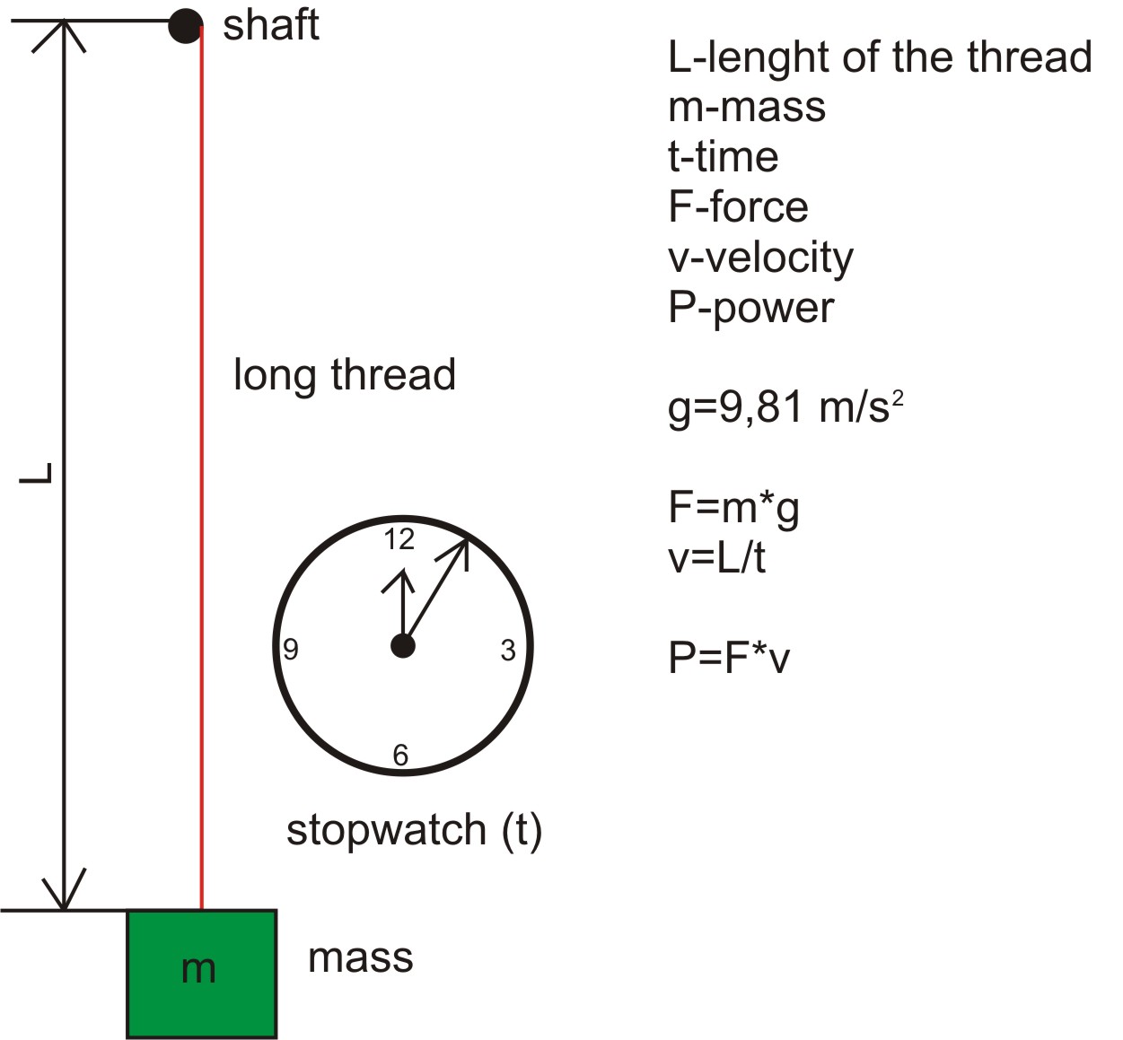

Ok, I finally got the spring scales, they seem axactly like Peter used in his dvd. A friend helped me with the measurements. While he loaded the wheel, I monitored the RPM's, volts and amps. Amp meter was put before the insulating diode, so that it showed only what the motor actually consumed and not what the power supply was showing. Also the voltmeter was attached across the capacitor. It always showed about 1V less voltage than the power supply voltage. I did numerous tests with two different input voltages. All the tests showed that the more I load the wheel, the better efficiency I get, but the efficiency is still too low. For example, here is one set of the test measurements:
Input voltage - 11.42V
Input current - 2.45A
RPM's - 2655
Scale1 deflection - 100 grams
Scale2 deflection - 10 grams
So the input power is 27.979 watts or 0.0375 HP.
The wheel circumference is 0.5 feet, so at 2655 RPM's there are 22.125 feet per second.
If I sum up both scale readings, I get 110 grams. If 1 gram is 0.00220462262 pounds, then 110 grams will be 0.242508 Lbs
To get the foot pounds per second, I must multiply the pounds with the feets per second. That would be 0.242508x22.125=5.3655 foot pounds per second.
Now, if we divide the foot pounds per second by 550, we get the output HP.
So 5.3655/550=0.009755HP
This means that the efficiency is HP(out)/HP(in)x100 or 0.009755/0.0375x100=26.01%
I got similar results with all the measured values. So what could be wrong? Are there a mistake in my calculations or measurements? Or could the problem be somewhere else? How could I find the problem?It's better to wear off by working than to rust by doing nothing.

Congratulations on finally getting all of the parts together to make your own dynamometer! You are now in an excellent position to start testing you experimental motor.
From what you said in this post, there are still a few things you don't understand about the process, so I'd like to help you through it.
The first thing is, I am unclear exactly WHERE you have placed your input ammeter. Could you please post a complete schematic of your circuit and show me where the ammeter is placed?
Second thing is the method of reading the scales. The proper reading of the scales is the DIFFERENCE between the scales, not the sum. Also, to get the best results, the pressure applied by lifting the scales should be backed off until the low reading scale reads ZERO. That way, the high reading scale is the full deflection. This is the method I demonstrate on my DVD.
Third thing is that you and Lighty have already determined the best conditions for running your motor, where the recovered energy is the highest. This is the speed we want to run the motor UNDER LOAD on the dynamometer.
Fourth thing is under these conditions, we only want to monitor the power (current and voltage) actually coming from the supply to keep the system going. We don't care how much the motor actually uses, which we KNOW is COP<1. All we care about is how much WE have to put in to keep the process going. THIS is what can be COP>1!!!!!
If your motor can produce 60% mechanical efficiency AND recover 60% of its electricity and return it to the capacitor in the front, then we should be able to measure the motor's efficiency at COP=1.33 because the motor will be able to produce 60 units of mechanical energy for every 40 units of REPLACEMENT electricity we need to supply!

this is the circuit I used with the amp meter in it. It shows the current that the motor is actually using. If I connected the ampmeter between the insulating diode and power supply negative terminal, it would show less current (only the part that is taken from power supply). When I made these tests, I used the same commutator wheel as before, it has one 65 degree gap on each side (180 degree apart). There was no LED pulsing, so the energy recoverey was at about 30-35%
I also made changes in my calculations so that only the difference in both scale readings is used to calculate the torque, this gave even worse results with efficiencies around 20%. Test results where there was a deflection only in one of the scales, remained the same. I used a rather narrow leather strap, about 4mm wide (did not have anything better). Using this strap I could load the motor with up to 25 grams till the other scale also started to deflect.
Anyway, the calculated efficiencies are so low, that either I did a mistake in measurements/calculations, or there is something wrong with the motor.
