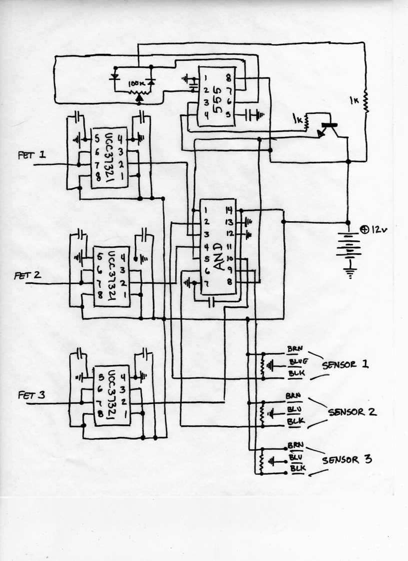

So.. I've been working a lot with this circuit now and am getting pretty comfortable with it thanks to everyone here. I've come up with what I THINK is a good schematic, but I would love to see what all of you think of it?
I've uploaded a schematic in this forum..
The sensors are SX672. I like these sensors because the mount very easily, and are quite versatile in their configuration. My thinking is that if I control the fet at the gate, I can control the motor with a low voltage system, and still send larger voltages to the coils of the motor.
I hope you all can see it. If not, I'll host the pic somewhere and repost if that's ok.
Thanks in advance for any advice or concerns!
