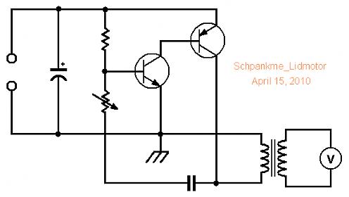

            • Inverter circuit for the Plant Battery
              @ Jeanna & All
              I made a simple two transistor inverter circuit for the plant battery that seems to run LEDs better than a Joule Thief circuit. Jeanna this is kinda along the same lines as what you are doing----uping the voltage.
              I found that I can add a small solar panel in low light also and help with the power. The two work well together.
              YouTube - Plant Battery inverter circuit.ASF
              Cheers,
              Lidmotor

                        • Circuits
                          I built your rendition of the circuit and it works about the same as the one in my video. I was very surprised that the same basic components could be wired up in two different ways to produce similar results. It is fun to play around with the different values and watch the performance changes. What I have been working towards is a LED blinker circuit that is just fast enough to appear constantly on. About a 60Hz is all you need. By doing that you can use the plant battery energy better. There really isn't much power there but I really like that it runs non-stop for weeks on end. The plant really doesn't seem to mind. If I can keep the plant alive then replacing the metal pieces once in awhile isn't going to be a problem. Consider it doing gardening work. Maybe get the wife to do it like you said.
                          Lidmotor

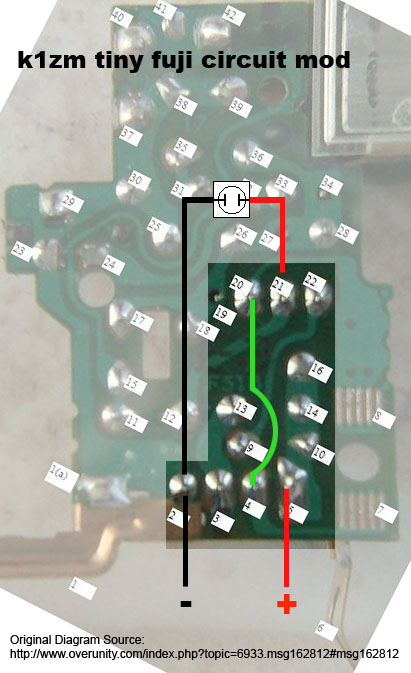

                          • Yet another use for the fuji camera circuit
                            YouTube - Plant Battery lighting a Neon using a Fuji camera circuit
                            • Great work Kazm!
                              I never realized the fuji ckt could be so small, and I love how you showed it so clearly.
                              And... I really love how the plant battery can light a neon!
