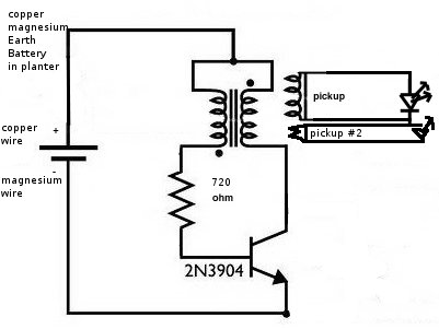

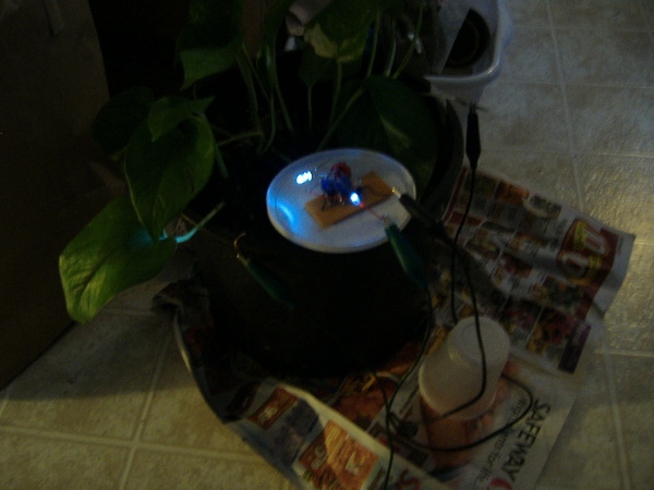

    • another circuit running from the planter
      OK
      The shoebox provided me with another circuit to try on the cu mg planter battery.
      In this picture you see 2 leds.
      These are from 2 separately wound secondaries (pickups) on the same toroid. It is an early circuit. I ran out of room on the toroid and needed to refine my design, hence the shoebox.
      So, the cu wire - mg ribbon in the soil around the philodendron plant are producing close to 1.5v and enough mA to start up the pulse generator known as the joule thief with secondary. And this one can light 2 leds.
      Here is a pic and a circuit.
      [note: there is NO memory cap in this one!]

        OK
        jeanna

                              • Jeanna's Plant Battery----my replication
                                @Jeanna----I couldn't wait for my magnesium ribbon to come in the mail so I tried your "Plant Battery" using the metal in a "magnisium fire starter" that Walmart sells. It worked GREAT!!!
                                Here is the video of my success. Thanks alot for sharing this idea with us. I will build a special JT for it and see how long it runs.
                                YouTube - Plant Battery Running a SEC.ASF
                                Lidmotor
