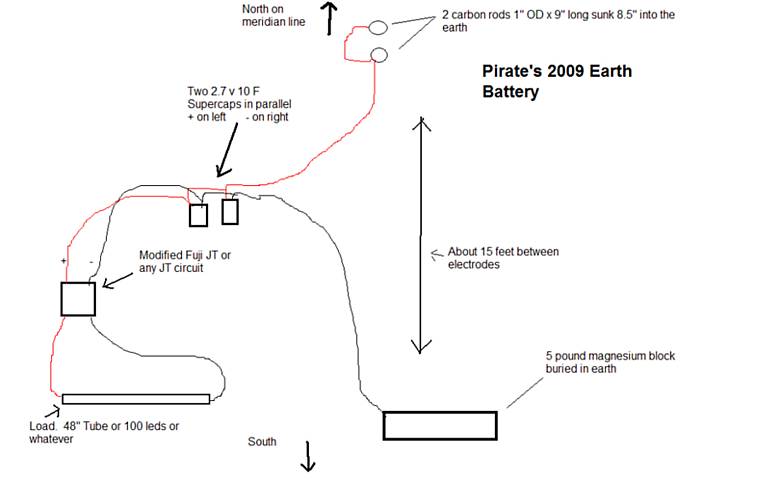

          I can only do this will help from you Bill I need a drawing of the setup you have, with link too product to buy.

            I have no drawing and I guess I could make one but it is just simply some rods stuck in the ground on the proper alignment as described. I make terrible drawings (see some of them at OU.com) but I can give it a go. Gadgetmall has a ready made earth battery kit on his website. If you look at any of his post at overunity, (like in the joule thief topic) you will see a link to his site at the bottom of his posts. I believe he is charging $55.00 plus shipping and it has both the carbon rod and magnesium rod. I would post it here but I don't know the rules about promoting stuff like this. I suggest anyone interested to ask him about it as I am not endorsing this one way or the other. It might be a good way to get the materials which can be hard to find in some/most areas.
            I read this topic from the start and I wanted to point out that the part about the ground being wet is not what I have been seeing. When it rains and the ground is wet, my output drops a bit. When it is dry, totally dry with no rain for weeks, my output raises. Others in various parts of the world have reported to me the same thing. This is one of the things that makes this different from a water battery, or galvanic battery in my opinion. There are some other reasons as well which we can discuss later.
            I will try to make a drawing. (Promise not to laugh)
            Bill

                • Pirate's Crude EB drawing
                  Here is a crude drawing of my current set-up. ***EDIT*** Sorry, left out that the carbon rod is the plus and the magnesium block is the minus.
                  Bill
                  • Originally posted by Pirate88179 View Post
                    Bill
                    thank you
                    I have just ordered 3X Super Capacitor charges in seconds 20 Farad 2.5Volt.
