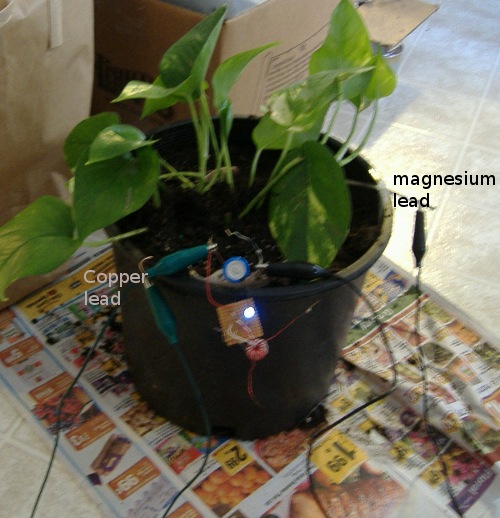

                      Hi everybody,
                      I finally made an earth battery that lights a joule thief
                      The winning details are:
                      Cu and Mg
                      one pair is all that is needed.
                      joule thief needs to have NO resistance at the base.
                      When I shorted it as Freepow suggests, it lit right up.
                      The soil is a little damp and I assume the moisture will take some time to regulate itself in the pot.
                      There is a plant too.
                      Part of the idea is that the micro organisms may resupply ions to the mag ribbon and keep it from disintegrating. Time will tell, but for now this is my success number one on the earth battery. !!!
                      I posted a pic at the thread for eer running a jtc over at ou. Here it is:
                      post with the pic of this.
                      jeanna
                      edit.
                      After some fiddling it works with 1k ohms at the base resistor.

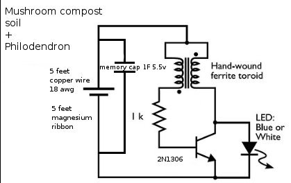

                        Do you have a full schematic you can post of the entire circuit with rods?
                        • schematic
                          Thanks, Aaron.
                          Here is the schematic.
                          It is a standard joule thief circuit .
                          In this case I am using a circuit I made for earth batteries because I was getting such low voltage. It happens to be the only unassigned circuit in the house and I connected it.
                          I am sure a regular 2N3904 or 2n2222 will work just fine, but I would have to make one to check it.
                          I will be doing that because I have been using this to discharge my spikes-charged battery, so I will need it.
                          Oh happy day!
                          jeanna

                            • Originally posted by jeanna View Post
                              Thanks, Aaron.
                              Oh happy day!
                              jeanna
                              great work jenna
                              Congratulations
                              • Jeanna's "Philodendron Battery"
                                Thanks, Aaron.
                                Oh happy day!
                                jeanna
                                Well you did it again. That is something that I must try---a "Philodendron Battery". My first reaction to this was that it is just a nice looking-- plant killing-- galvonic battery. It was your choice of house plant that caught my attention. I have decided that the Philodendron house plant is one of the toughest organisims on earth next to the cockroach. The reason I decided this was because of the one that is still alive on my boat now after 34 years. It has survived much abuse and little attenion but lives on.
                                I have been working on several projects that can run on very low power and I'm anxious to see if your house plant battery will drive any of them. I do think that the metals in the soil might kill the plant but if any plant has a chance of survival---it's the Philodendron.
                                Thanks for sharing Jeanna.
                                Lidmotor
