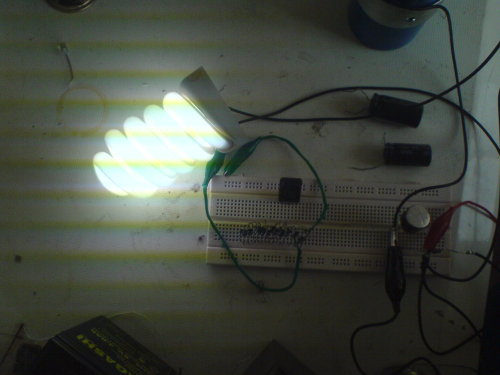

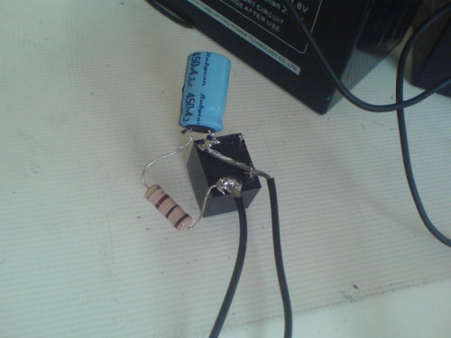

              I finally built the unit but the result was less than impressive.
              I used a 100uF 450V capacitor instead of a condensor which I did not have, and my coil's primary is 3.1ohms and secondary around 10000 ohms pretty near the values Imhotep's coils has. I used a 12V relay, because I did not have a 9 volt one and the resistance of its coils was about 420 ohms pretty near Imhotep's. I used a 40W tube for the output coil.
              The current draw from the 12V battery was around 1.3 amps and the current into the charging battery was about 10mA. The brightness of the tube was less than the experiment I did before with a mosfet. When I tuned my circuit it could light the tube with out wires or even one wire only, but this circuit does not behave like this, I wonder if I have not done something right?
              The schematic is exactly the same as Imhoteps except the condensor and the 12V relay.
              I wonder how to reduce the current draw?
              Edit: I attached a photo of the running light + the relay

                i liked your fet idea nice low current draw .
                i was not able to get specs on condensers for point systems and i searched all over the net ,so people could sub a cap .maybe someone can find the specs and post a sub .
                i actually had the best low current draw from obsolete relays from radio shack as well as a few from nap tvs from the 70's but peters choice was a good sub but drew a little more current. as the bulb warmed up the current draw dropped be low 1 amp and charge current went up and had good spikes on scope . have fun with modifications ,i have many more releases coming soon !!!

                      So current draw of 1.2 - 1.3 amps is ordinary for this circuit? The other problem was the flickering of the tube, is this normal too?
                      Yes the current draw drops after warming up a bit. And i used 16W bulb and the light was good! It is drawing about 1amp at 12V.
                      Thanks for the circuit, the experiment was interesting although it needs some work for making it something useful for lighting the house.
                      Looking forward for more circuits!
