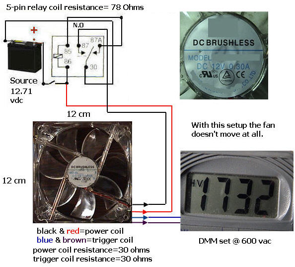

                          • HV Fan Transformer
                            I just want to share my findings. The attached photo has details. I haven't put to use the voltage spikes yet.The nameplate of the fan says that it uses 300 mA[0.30A]of current as per original configuration.
