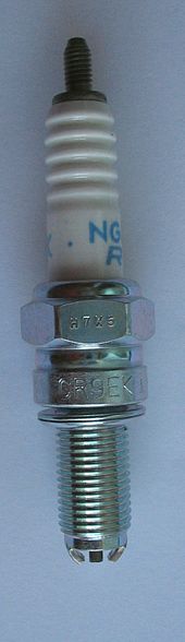

            Spark Plugs
            Now let's examine the common internal combustion engine spark plug:
            Spark plug - Wikipedia, the free encyclopedia
            Let's learn some more about them from an alternative source, here is a particularly informative article from 1977:
            How you can read spark plugs and select them - by Gordon Jennings.

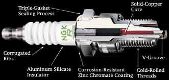

            Here we can see what NGK, the world leader, have to say about their spark plugs:
            Cutaway View
            NGK Spark Plugs USA
            Now let's learn about what the letters mean on the spark plug specification:
            Z1 Enterprises, Inc. NGK Spark Plug & Plug Cap Guide
            and a double check from NGK, the main manufacturer of spark plugs in the world:
            NGK Spark Plugs USA
            So we now know that spark plugs use a metric thread as an international standard, with 14mm being common, so we double check with a spark plug tool manufacturer:
