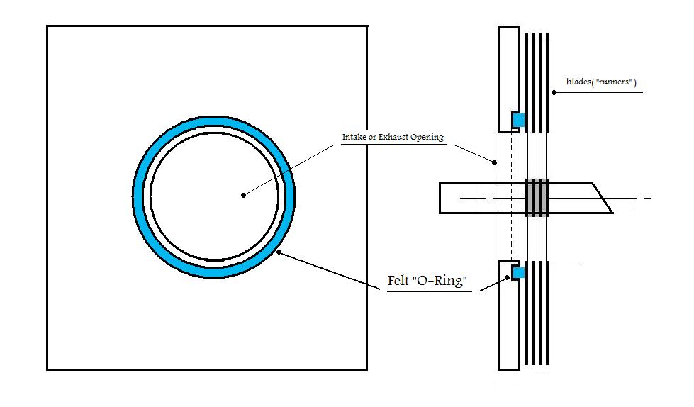

The turbine may require the seal, but if I'm correct, I don't think the pump
will require it. The air or fluid enters from the center and is directed to circumferance of the housing.. so all sides of the discs act on the fluid.
You could make a seal by cutting a groove in the housing just above the center inlet, wide enough to install a flat circular piece of felt, coated with lithium grease. It should be thick enough to touch the blade, but not allow to much pressure on the blade. Just an Idea.
I was thinking of an O-ring, but that might be to much resistance against the blade.
Paul
