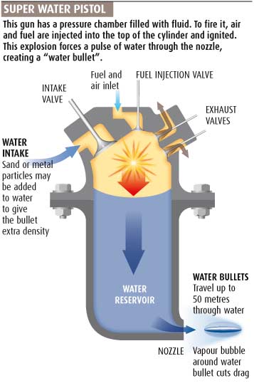

    And that image was a !wow! , no moving parts,
    one way check valve (wasn't it a one way check valve?)
    But again, something I'm unsure I could every recreate, Dang.

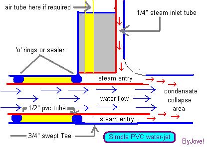

          Straight tube test works! I tried a 4" pvc tube with the
          1/4" copper tubing stuck into a hole in the top of pvc about 1/2" back
          from one end. The steam pushes water out the end as I had hoped it would.
          Path of least resistance is all I can claim is making that work.
          I have no idea how it works, it just does and I'm moving onward.
          When it stops working or can not be improved upon any more, then
          at that time, how it works would matter more than it does today.
          For example: not knowing the physics about how a siphon works does not
          prevent you from getting a hose and using it correctly to create a siphon.
          I have yet to find 1/8" copper tubing, I've not looked very hard yet.
          I'll probably just restrict the 1/4" hole by sticking something in it to
          narrow the output steam of steam.

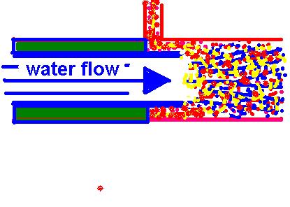

          Except for the sucking in of air, which I think might be much later design change. I'm unclear what exactly mixing in air does. I expect it might ease
          the mixing. Instead of larger bubbles of steam it would allow smaller ones to mix into the flow of water. If the air is left out until later, then what the air is doing might reveal itself then.

                Okay, get some 3/4" pvc and place the 1/2" internally. Then decide how you can get the steam into the gap between. Maybe an 'O' ring would do? ~I would shorten the tubes to say 6" for the 3/4" tube and 3 or 4" for the 1/2"?
                That setup should enable you to see some results. Consider also, using a 3/4" Tee-piece with short tubes either side as I first suggested, and the 1/2" pipe running inside but only just going past the the Tee vertical on one side. You can use putty, plasticine or silicon to seal the gap between the two pipes, but this will introduce the steam in a circular motion around the 1/2" pipe before hitting the cold water and condensing.

                I also read a small description of the water-jet which I had missed or wasn't mentioned before...
                When used for boats, the engine works by injecting steam through a rear-facing, ring-shaped nozzle into a cylindrical chamber. As the steam emerges at three times the speed of sound, it rapidly condenses, generating a shock wave that pulls in water through an intake and expels it from the rear, generating thrust
                three times the speed of sound ???
                ...from what I read ref pulse jets, I'm sure the pulsing cannot be more than the speed of sound. Disinfo or the reason why the water jet is so powerful?
                I also found another strange, yet similar item, see image

                    I think you have missed the point. Maybe this wasn't clear enough?
                    Get some 3/4" pvc and place the 1/2" internally. Then decide how you can get the steam into the gap between. Maybe an 'O' ring would do? ~I would shorten the tubes to say 6" for the 3/4" tube and 3 or 4" for the 1/2"?
                    I have drawn a quick illustration of what I mean, sorry it's so poor, but you should understand that the tape which you stuck on each end is restricting the action. It needs to be on one side of the steam inlet only, coloured green in this example. This leaves a larger area on the right hand side for the collapse and thus should pull water through.
                    Thats how I see it working anyway.
                    I have just added another diagram to illustrate how I think a simple water-jet could be built using a 'solvent-type' 3/4" pvc swept Tee and a short section of 1/2" pvc tube. This would be very basic to test the idea, then you can add the coanda effect or angle the tubes to improve the mixing and flow. This would be negligible cost to test the theory!
                    "I say that if a TEN year old can do this and win, what the **** is wrong with the whole World?"
                    ~ John Bedini ~ 8 Mar 2000 - http://www.keelynet.com/bedmot/bedmot.htm
                    • #55
                      Yes, that looks good. I didn't try that.
                      yes again, that's good. It is doable but I believe, that design requires more pressure to get it functioning at 360 degrees around the tube instead of only at the top of the top where the steam enters the device.
                      Clear tubes would allow actions to be viewed and confirm that of which I'm speaking about or dispute it.
                      The steamfish design isn't limited by standard size / off the shelve tube sizes. it could be easier to scale down and up in size.
                      Limitations on sizing are not as great.
                      You do not have the required 360 degree mixing to deal with requiring higher pressures. You can scale it down to match your steam flow, easier.

                          Images, sorry it took so long
                          1st test device
                          2st test device
                          1st Steam Fish Top View
                          1st Steam Fish Bottom View
                          1st Steam Fish Side View
                          Steam Maker 01
                          Steam Maker 02
                          Steam Maker 03
                          All these images where taken with a web cam and they are not very good.
                          I hope I can get a video up showing the 1st Steamfish design.
                          Edited this msg, added this video of the steamfish. This is a really bad video, but ...
                          Any movement you see in the steamfish is steam, the water isn't visible in the video. I'll try another video in daylight.
                          The idea behind the this 1st steamfish design was to just make one and
                          observe what happened. I was not trying to get it "right", just make
                          something to test with.
                          Yep it's crude stuff, but why spend time making anything
                          else if it has not proven itself to be worth extra effort.
                          The plywood has looked like a great LANDING ZONE to the cats
                          and they have knocked it over a couple of times
                          and I just hope the stay off it during experiments!!!
                          Randy

                            I have just come across this while researching and it may offer some insights into improving the design. It is referred to as a Scramjet.
                              Ramjets operate below Mach 5, Scramjets only operate above Mach 5 !!
