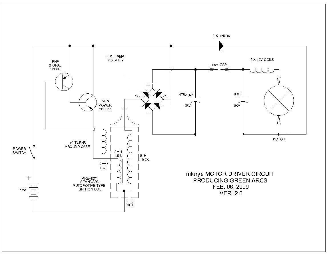

Revised mlurye Circuit Drawing Ver. 2.0
Dear mylurye,
Here is a revised schematic per your changes. Check my bridge connections. I don't know for sure if you prefer to drive the spark gap with the (+) swing or the (-) swing.

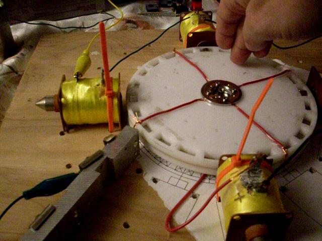

I know you like to keep your comments brief, but I'm in need of a little more description of what you are using for a motor. Due to technical reasons (land line) I'm unable to review your fine YouTube clips. If I could I wouln't be bothering you with such simple questions.
If you have a moment could you describe:
1. The gap distance
2. size and type of storage battery
3. proper polarities - I'm sure I've made some mistakes here
4. History of the circuit if there is any thing to share.
Thank you in advance, and thanks again for sharing this circuit.
Mark McKay
