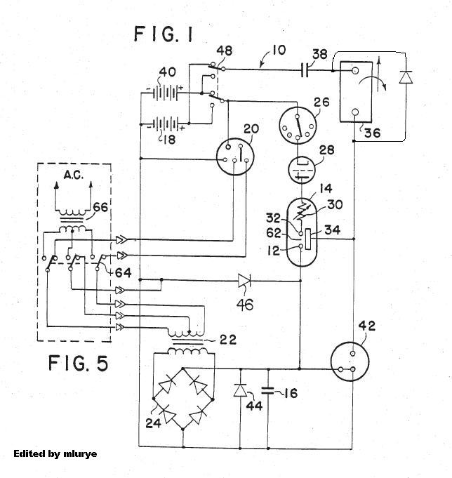

    • Guys,
      I don't know if anybody noticed. But schema that I created is hybrid between latest Gray's patent and first one.
      I was thinking some more on how to make this schema with CSET and to make it work. It's missing one key component!!! Check out my idea.
      Mike

        • Originally posted by mlurye View Post
          Guys,
          Good thinking, Mike. I've been looking at a diode in this location to charge the top capacitor, in my setup circuit. This corresponds to capacitor 38, which I consider to be the operating cap. One of Mark's "GD" pictures shows this very component. It's at the bottom front of the CSET, connecting the grids' white motor wire with the capacitor 38. My basic circuit doesn't show my diode T-tap, or the switch which allows it to trigger the Overshoot gap, to fire the motor.
          In the Investor photo, capacitor 16 is in the Black Box sitting on the floor. There's a small wire running to the CSET electrode, on the far end.

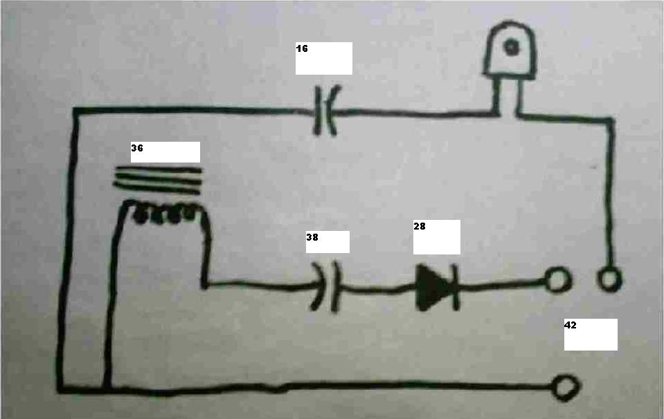

                          • @Electrotek: Could you make a picture of your setup?
                            Mike
                              Here's the picture:
                              The defibrillator inductor is at the very top, with the 'hot stick' dowel rod stuck in the hole, for storage. The big cap it's setting on is 38. And the blue wire to the diode is the arc gap, which is 42.
                              Not shown is the diode T-tap from the other end of the diode to the arc.
                              • What is the value for cap 16? And actualy if you can provide params for all your components it would be realy good. Also could show your power supply and how it is connected?
                                I did markup your picture. Is it correct?
                                Mike
