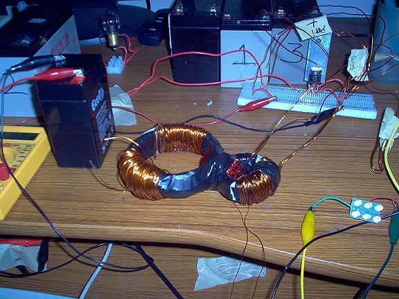

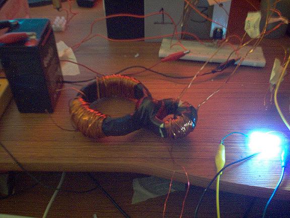

Hi Skywatcher,Originally posted by SkyWatcher View PostHi folks, thought i would share what could be novel results, though would like to get some feedback as to whether others have seen similar effects and your thoughts. I am using 2 toroids tied together like another fellow did in a youtube video, though i am using one toroid made from steel enamel coated craft wire at about 4 inch diameter and the other toroid is from a computer psu at about 2 inches diameter, ferrite i think. And tied the 2 together with 24 gauge magnet wire with maybe 200 turns, then on the smallest toroid adjacent to 24 gauge coil i have the bifilar 18 guage self oscillator joule thief type setup, though wired bedini style. The result is that when a load is applied the input amps drop and when the secondary which is tied between the 2 toroids is shorted, it drops even further. Though this may be simply back emf fighting against my input voltage causing this, however when i put 6 leds as a load on secondary i can adjust input by lowering base resistance which increases leds brightness yet input amps stay the same and at some points, drops a little bit. At 6 volts and between 15-20 milliamps input, it lights up the 6 leds to almost full brightness. Your comments are greatly appreciated.

I would need a picture to be very sure about your set-up.
I can, however say that this is totally normal when using the secondary from a joule thief.
I have no idea if you are gaining any benefit from the complex of toroids (unless you are able to wind more turns onto your secondary).
In general the battery of joule thief runs a transistor and if there is a secondary winding sharing the same toroid as the joule thief bifilar, you will get high voltage on that secondary which is unaccountable by normal transistor equations; and, the effect of what you draw from that secondary has little to no effect on the draw from the battery.
That said, it is important to remember that a transistor can use considerable amps from the battery.
Lidmotor showed me to put a rheostat coming right off the battery to lower the draw.
I hope this answers at least some of your question.

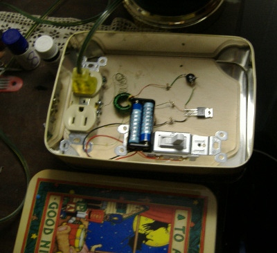

This is my new Joule Thief Power Unit!
The pictures are
The JTPU, which is a joule thief with a 3/4 inch toroid with secondary where I connected the secondary to the wire points of the plug unit. I split the red battery wire so it encloses this wall type switch.

I can put a second lamp into this JTPU as well.
It dims the lights a little but the total light is more with the 2 than with just the one, so, it does not steal it all. And, I believe this is capturing what is being lost to dissipation with only one lamp.
I am using 2.4v to power this to this level of brightness. (maybe even 2.33v)
It is too late tonight, but I should do a run down time on this jtpu with this lamp. It seems great, but you never know til you try it.
