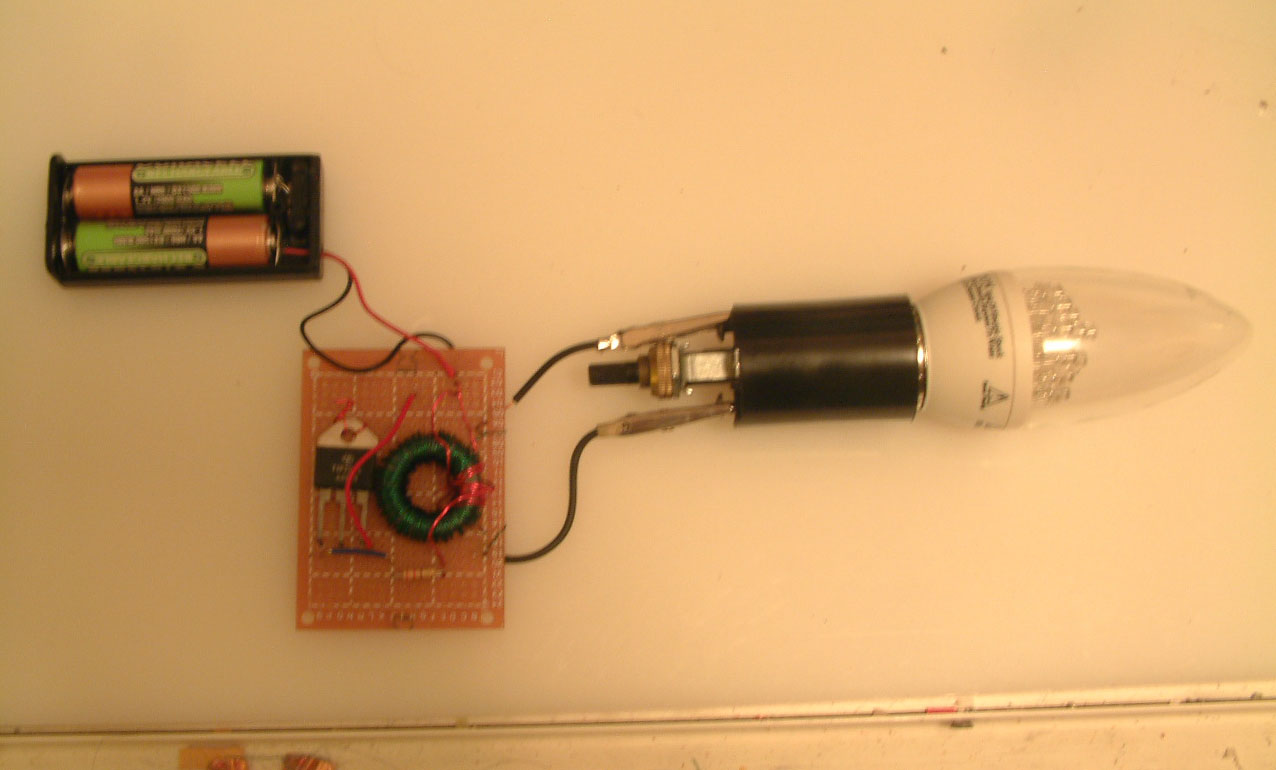

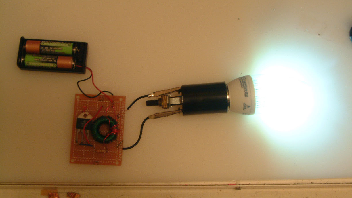

              • Hi all, I recently found this forum and have had great fun replicating and learning from these circuits, much thanks to all who contribute to making this forum what it is!
                Wanted to chime in with my replication of the "Jeanna's Light" circuit, specifically the one with the smaller toroid and led bulb:
                PARTS:
                * TIP3055 transistor
                * 1k ohm resistor
                * 1 inch (outer diameter) ferrite toroid with 3 turns (22 guage) and 9 turns (24 guage) on the primary, 85 turns (26 guage) on the secondary.
                * Lights of America 2025LED-65K-24 LED 1.5 Standard Base Chandelier Style Bright White Light Bulb (Un-modified).
                RESULTS:
                * This is giving me the best level of light i've gotten out of my circuits so far. Previous to this i've made fuji based cfl drivers as well as the allelectronics-big-toroid version of jeannas cfl light, and both are noticeably dimmer in comparison.
                * Runs for 3.5-4hrs on 1 or 2 AA batteries (decent light with 1 but is stronger with 2).
                * Makes absoutely no noise at all! This has been confirmed by my girlfriend who can hear even the most subtle high pitched coil whine
                I'm planning to box this in a project box with an wall style outlet (it's actually a 3-prong to 2-prong adaptor) into which i can plug my lamps.
                @jeanna - i've seen it mentioned in earlier posts that having a "center tapped primary" can produce better results, but i'm confused by what this means. How would I modify my toroid of 3, 9 and 85 windings to be center tapped?
                Cheers,

                  • Originally posted by kazm View Post
                    Cheers,
                    kazm
                    Very nice Kazm!!
                    You are already making the centertapped primary. If you were not, the jtc would not be working.
                    So, I have a question
                    Did you modify that light?
                    I have made these with and without modification and the unmodified ones continue to oscillate through the switch til the battery is dead.
                    Somehow the caps are continuing the oscillation which must be effecting the primary which is keeping the transistor alive and THAT is keeping the battery involved.
                    The only way I can stop it is by removing the battery.
                    2 batteries will often be brighter, but more secondary turns will also make the lights brighter.
                    I have one that looks like yours that makes 400-500v off the secondary and lights the bulb UNmodified.
                    For a modified bulb, just make one that lights a neon(the kind that comes with a resistor from radio shack) and you will have enough volts for full brightness, which is 172 spiky volts.

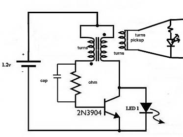

                    @nvisser
                    I have one on my desktop that is an old drawing but is basic joule thief with a secondary. I will post that. Please note the drawing shows the BJTL (basic joule thief light) which should be removed when using a secondary, as it sucks out the joules from the battery and kills it quicker than if you only use the secondary for lights.
                    thank you,

                    • Hi Jeanna, thanks! No, the bulb was not modified, I did test a gutted one but it's output wasn't as good so I've been using them as is. The light is strong but it's still not full brightness (when I plug into the wall I can still see a difference). I'll see if I can match it using more turns, or possibly the 3-directional winding you've described in http://www.energeticforum.com/renewa...html#post76741
                      Cheers,
                      kazm

                          hi jeanna, i took a look at got some interesting results.
                          first keep in mind that there is a capacitor inside the standard bulb. you can test this simply by turning your bulb on for a few seconds then off, then completely disconnecting the bulb. The leds will still stay lit with a very tiny dot of light for up to 5 minutes. that said, here's what i found:
                          with my circuit as it was (secondary wire not connected to the circuit, both ends going to the bulb) the switch did turn the bulb off - but only about about 95%. There was still clearly a small amount of light being produced which would only go away when i turned off the battery. i then noticed that when i touched the positive side of the secondary with my finger most of the light would come back (remember, this is with the switch OFF). when i touched the negative side of the secondary the bulb would go out completely. basically the negative side of the secondary needs to be properly grounded. i verified this by by connecting a croc clip from the negative end of the secondary to the battery ground connection. i turned on the battery, waited 10 seconds, then turned off the switch leaving the battery on. only the small dots from the capcacitor remained, and they went out after 5 minutes.
                          can you replicate?

                            • Originally posted by jeanna View Post
                              @nvisser
                              thank you,
                              jeanna
                              Thank you
                              That will be great!
                              • very old joule thief with secondary
                                OK here goes:
                                Remember to remove the BJTL
                                jeanna
